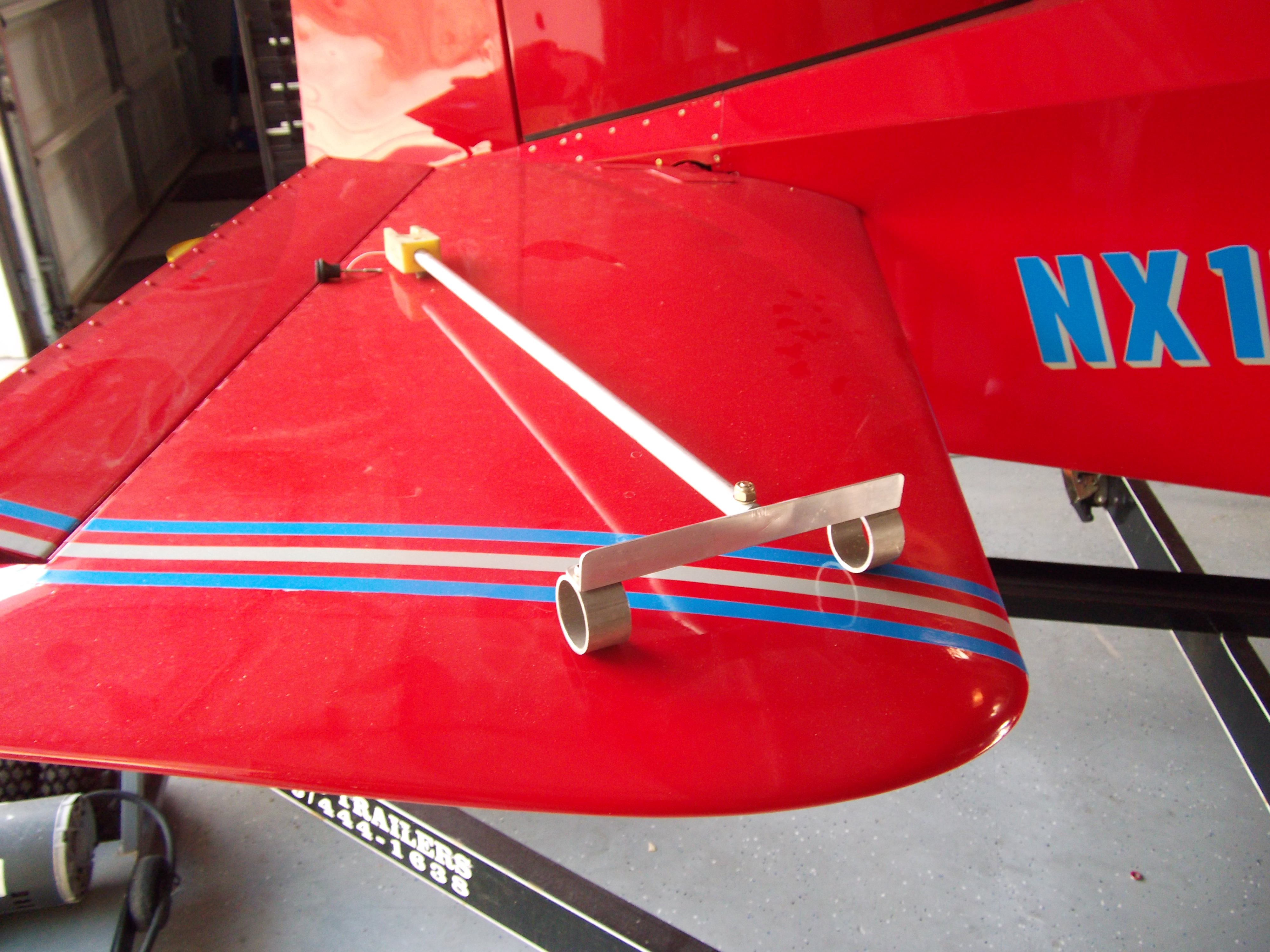

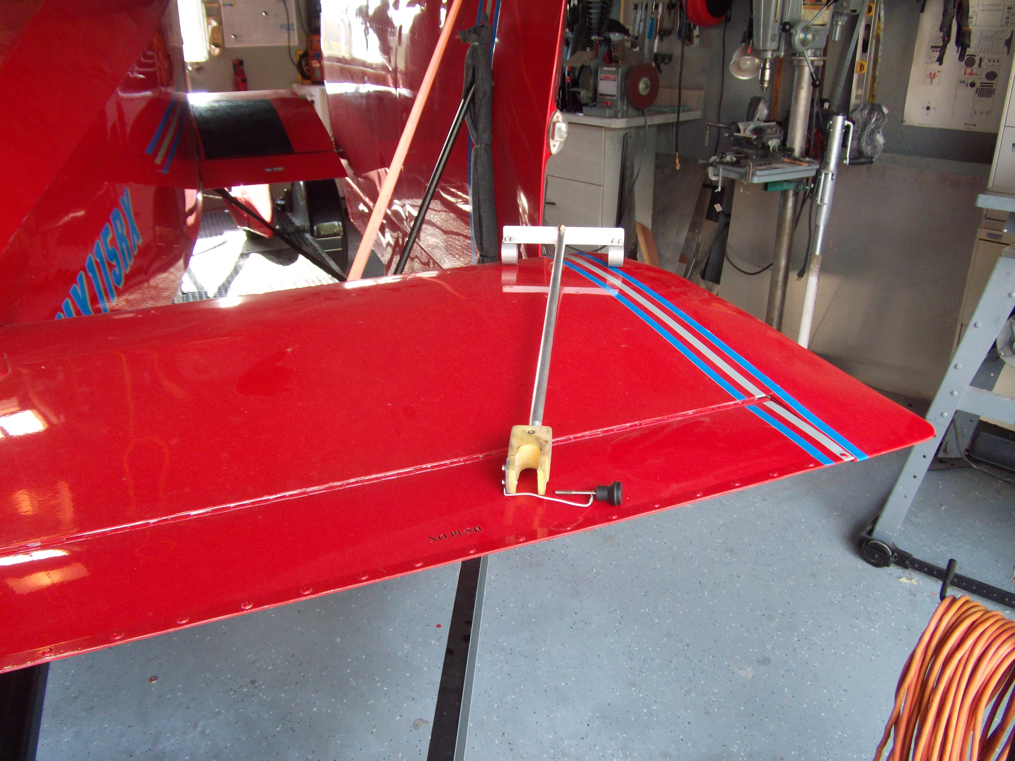

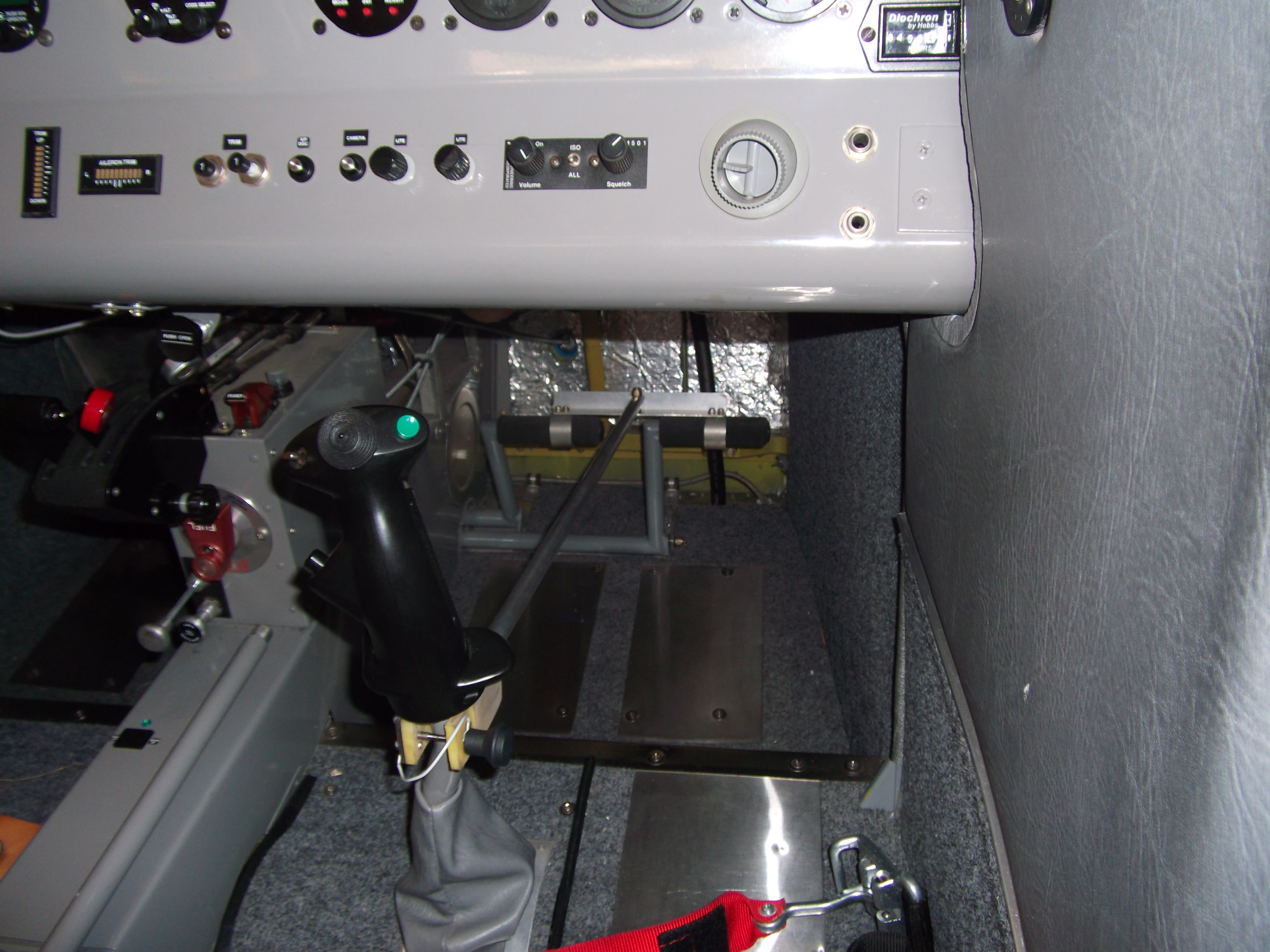

Control /gust lock . Can't take credit for this our good buddy John Evens came up with the design . :P Nothing more that some spare 3/4" tube , angle and tubing cut to make circles to fit over the rudder pedal legs . The top portion has a small section of nylon cut to fit around the control stick and tighten down with a threaded rod . If you have dual brakes this set up probably won't work . ???

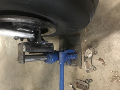

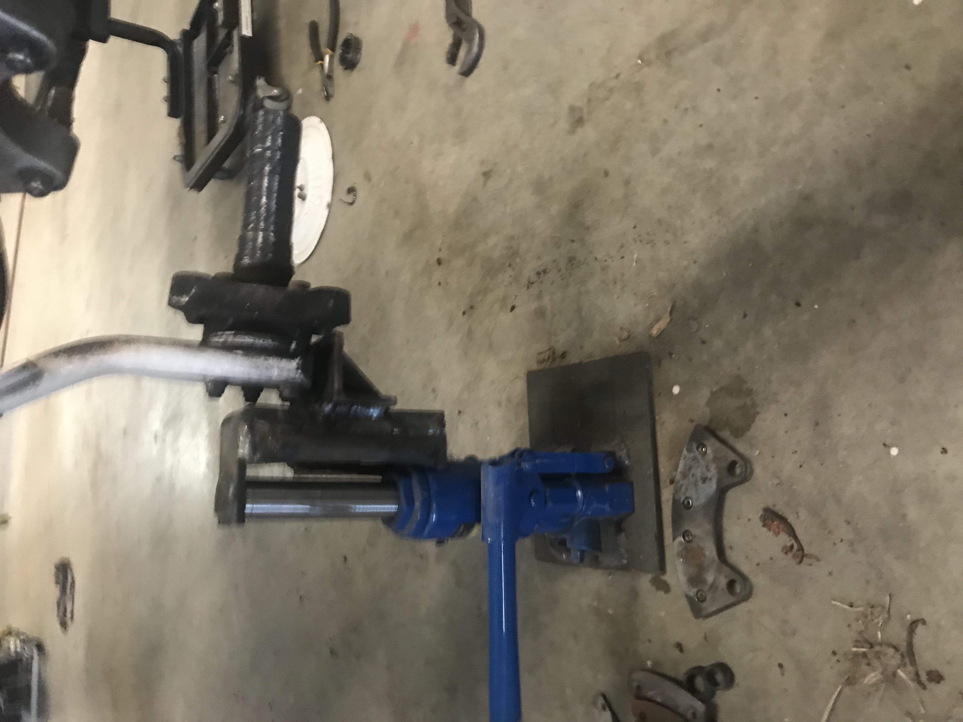

A guy here made this tribal jack a couple of years ago. No one ever gave it a try until today when I used it to do the wheel bearings on an AgTruck (the engine hoist is buried and will be brutal to dig out). This jack is too light for serious use on these airplanes. To much side load is causing the jack to bind while extended. I had to use a mallet to coax the jack to collapse but it may be a good solution for a Thorp since they weight less than half as much and wouldn’t need to lift as high. It’s just a cheap bottle jack with some scraps welded to it to catch the bottom of the strut. The AgTruck was very stable on it.
