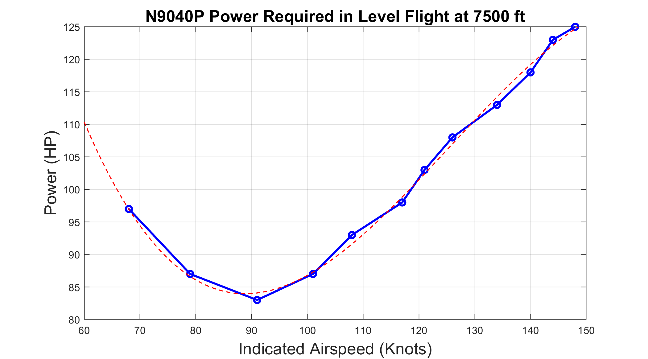

Travis and I had the pleasure of delivering a Thorp this weekend to new owners. With the owner's permission, we flew some performance tests in level, climb, and descent.
The attached image shows the power required versus airspeed plot for N9040P at 7,500 ft. I added a quick cubic regression through the data points (red dashed line), but it had some problems at high speeds - so don't take it too seriously.
Essentially:
The minimum power required is about 83 HP at 91 knots indicated. The best range airspeed is hard to estimate from the points. I'll work on the curve fit and update this later.
We ran the test be starting at the minimum speed, then applying maximum power and waiting for the aircraft to converge at the maximum speed. We then reduced the manifold pressure in increments of 1" of Hg and let the airspeed settle for each measurement. At the bottom of the power curve, further reductions in throttle led to loss of altitude, so we then switched to stabilizing at specific airspeeds and determining the required power to maintain altitude.
Ideally, we would have run this test at several altitudes and possible weight configurations, but we can try to estimate the sea level performance directly from the equation that I will (soon) use for the curve fit.
File comment: Power Required vs Airspeed of N9040P at 7,500 ft
2020_11_29__N9040P_Power_Required_in_Level_Flight.png [ 87.57 KiB | Viewed 44620 times ]

What’s the data logger log? I am thinking some people may have equipment onboard that would record the information. I know the Garmin G5 can record several parameters when an SD card is installed. ForeFlight with an AHARS source may be able to supply the information as well.
