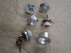

I installed the Vans locking retro fit fuel caps (aircraft spruce pn 05-01006) in my header and wings tanks. http://www.aircraftspruce.com/catalog/a ... fitfc3.php
the retro fit fuel cap is too small for the fuel tank openings, so I cut out a ring of aluminum (3-1/16" outer diameter with 2" diameter hole....thus making the "ring") from .091 left over from my panel build. This ring allows the retro fit fuel cap to drop into the 2" hole of the ring and the ring's outer diameter sits in the existing fuel cap opening. I roughed up all mating surfaces, cleaned the mating surfaces with MEK and used proseal to attach the ring to the tank, and more proseal to attach the retro fit fuel cap to the ring. It looks good, is basically flush, and I don't think I could beat it out with a hammer if I had to.

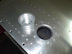

I machined my own cap, fits the standard S-18 tank neck, has flat Neoprene gasket, uses Allen wrench about a 5/16", You will split the tank before you blow it off. Drop it on, turn a quarter turn and then a half turn on the allen, done. It is flush, can be run on a C&C lathe by the bucket full, it has 3- components, well if you count the gasket it has 4. Dan

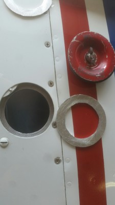

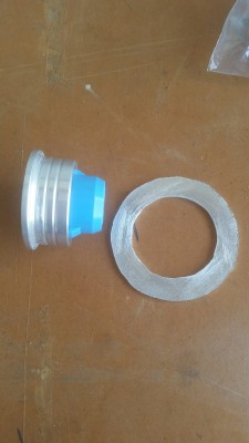

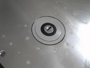

heres my setup with pictures:
here is the fuel cap that will sit down in the ring that I made:
heres the old cap sitting next to the ring I fabricated which will sit on the lip you can see in the opening of the fuel tank.
here is the ring and cap both installed in the wing tank:
Here is my best effort at taking a picture of the header tank showing it is basically flush with the top of the outer lip:

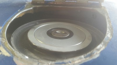

Here is my version of a fuel cap retrofit. I had a web page with all of this on it but comcast in their infinite wisdom did away with personal web pages, oh well.
Original installation when I bought my aircraft. I needed a 1/2" wrench to remove the cap and cover.
The new cap, it is an Mocal Aero 400 3" locking cap purchased from British American Transfer http://www.batinc.net/aero.htm, Aircraft Spruce also has them in their catalog. Why the 3"? because it would cover the hole left in the tank after I hacksawed the filler neck. I also purchased the mating mounting ring that has threaded nutserts on it. To install I used Permatex #2 sealant and the included screws and in 8 years have not had any leaks as far as I can tell.
I installed a door with a hidden hinge.
Why this cap? It is a quarter turn mechanical lock to keep the cap in the tank with an o-ring seal and a key lock to keep the fuel thieves at bay.
Just one more data point.
