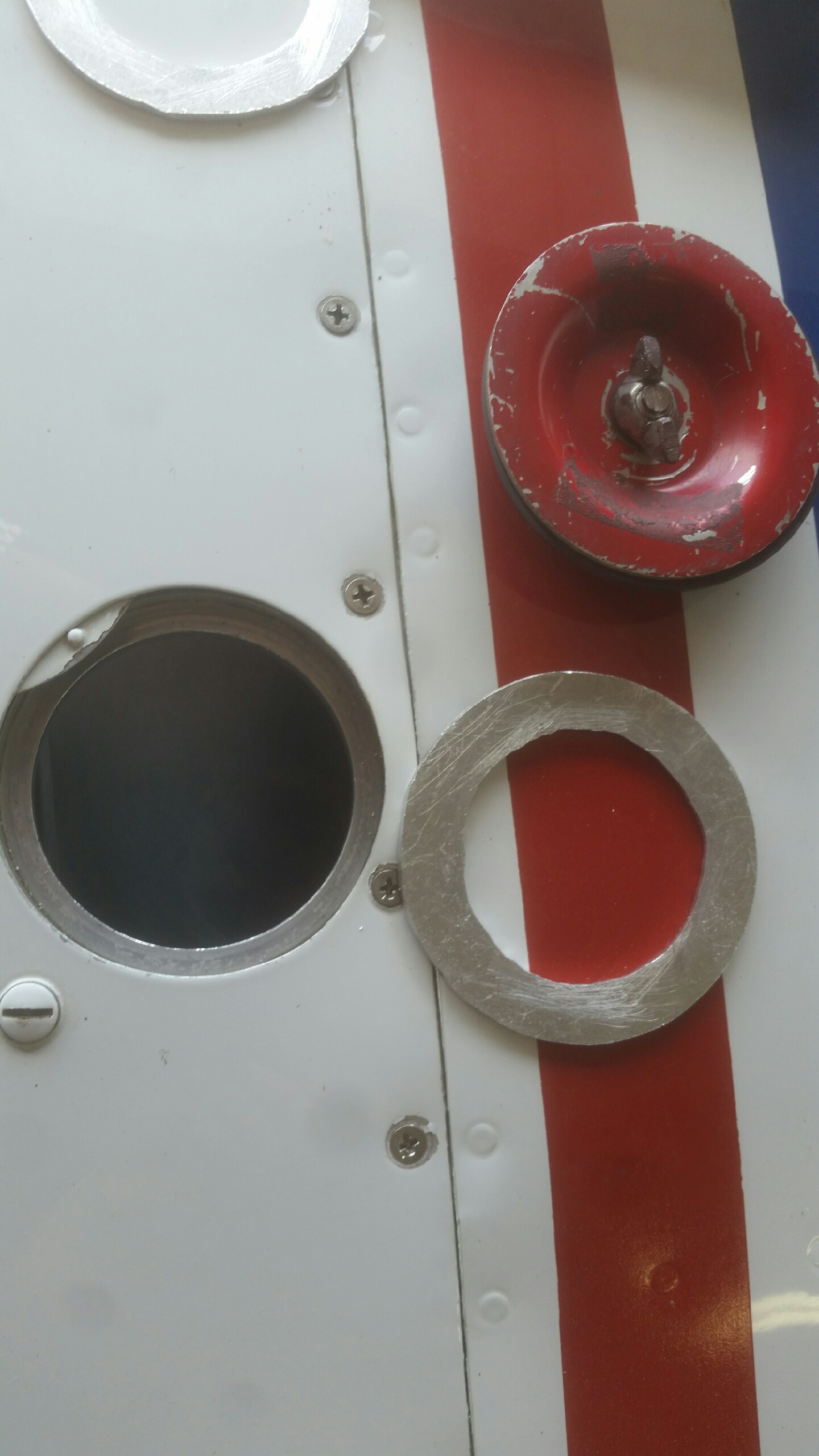

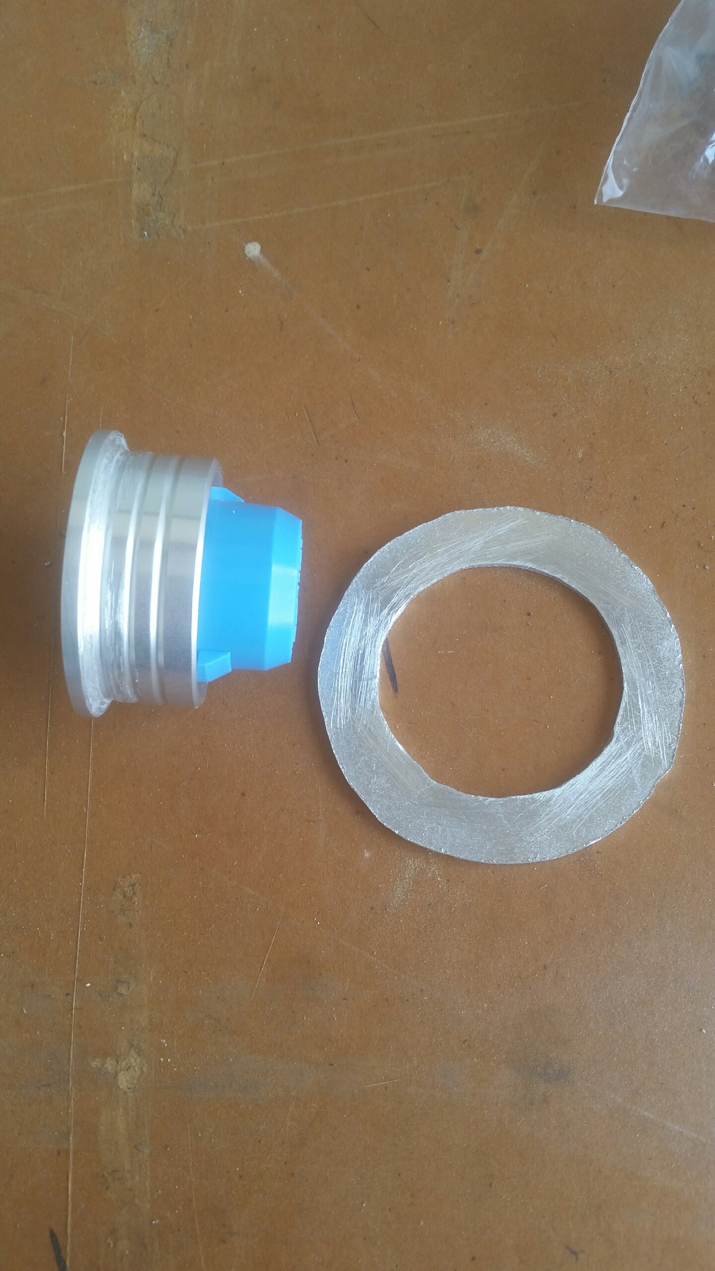

heres my setup with pictures:
here is the fuel cap that will sit down in the ring that I made:
heres the old cap sitting next to the ring I fabricated which will sit on the lip you can see in the opening of the fuel tank.

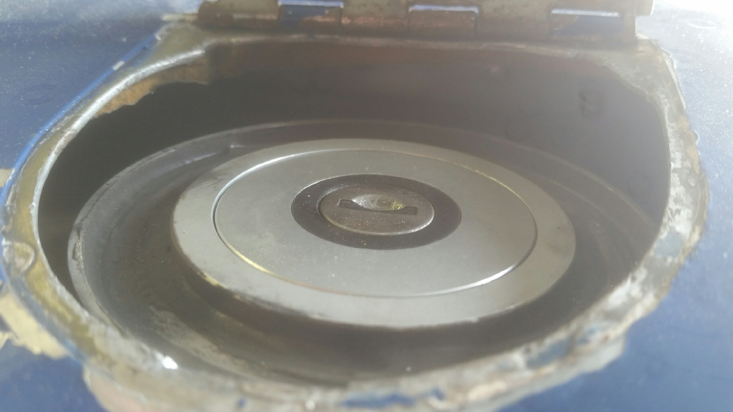

here is the ring and cap both installed in the wing tank:

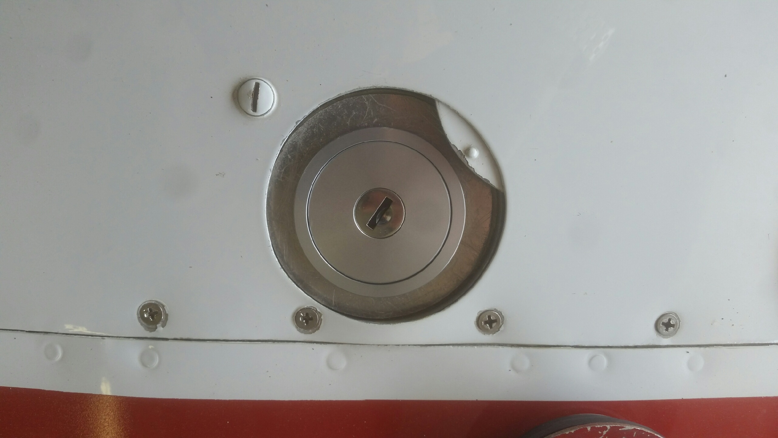

Here is my best effort at taking a picture of the header tank showing it is basically flush with the top of the outer lip:
