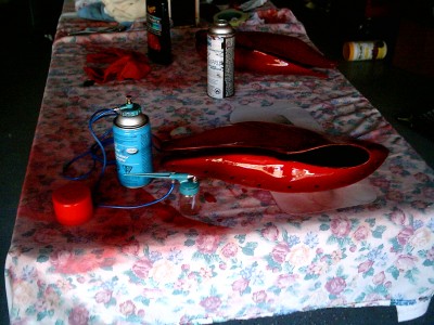

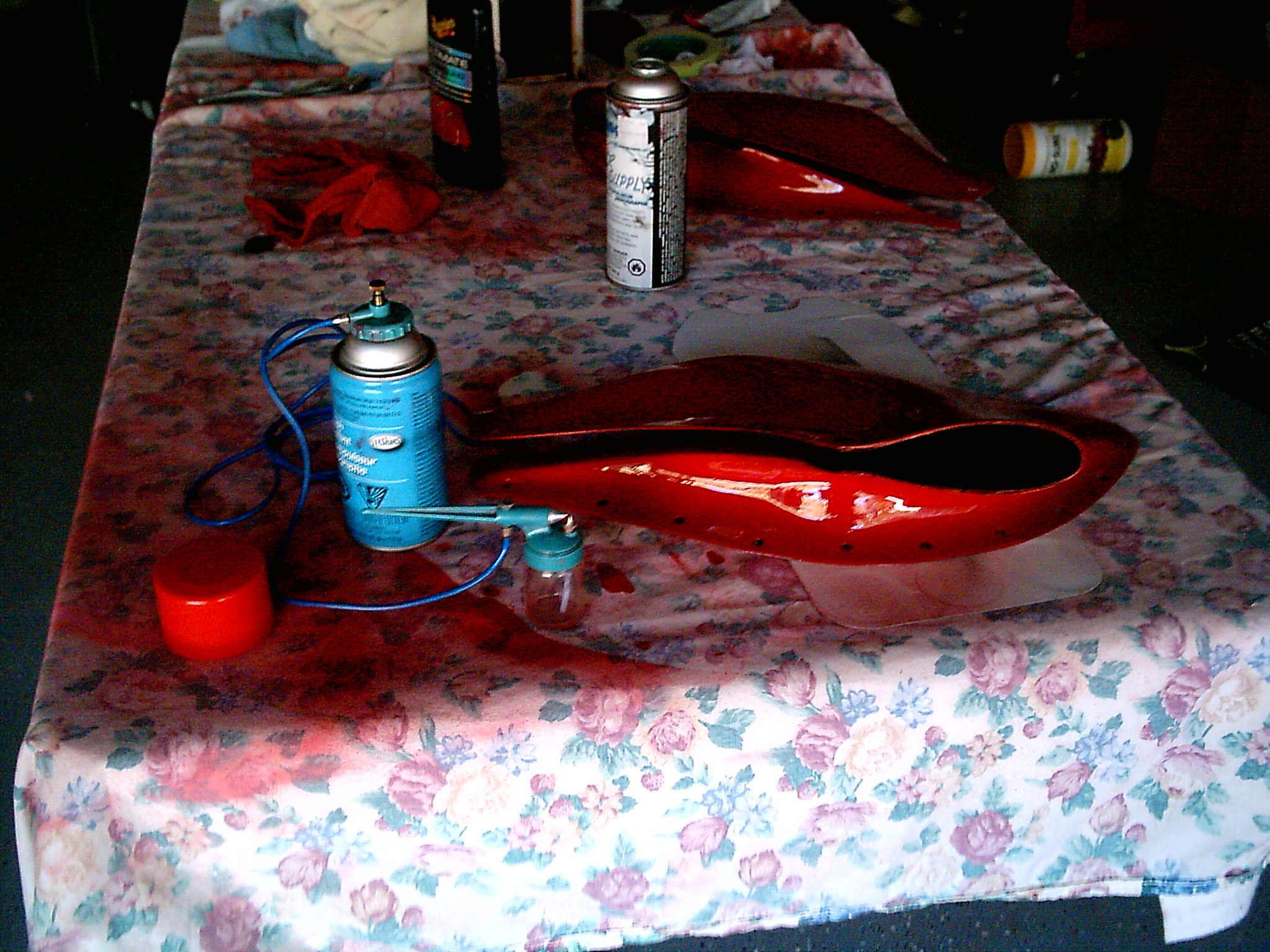

RB's tech tip of the week . During this annual I need to do a little touch up on the paint and repair a few fiberglass parts . Rather than drag out the compressor , hose and "BIG" gun along with mixing too much paint just to touch up a few areas , I bought out my 40 year old air brush . ??? Mix just a very small amount of paint and fill the little jar . You would be surprised how far the little bit of paint goes . Very little over spray and once the paint has cured all you need to do is buff out the area with a mild rubbing compound . No guessing on setting the air pressure , just hook it up to a can of air or you can get a small hobby compressor . I will probably get a small table top compressor as the price for the can of Jerry Brown approved air is some what expensive . ::) It is almost impossible to get a run using this air brush . 8) I did touch up about 4-5 parts using only 2 of the small jars ! :o You can get an air brush on E-Bay for about $10.00 ? ::)
