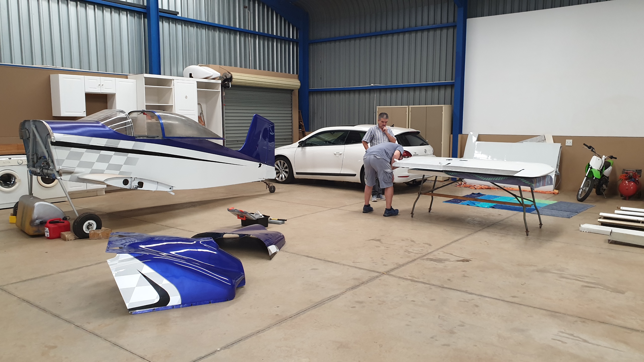

I'm in the process of restoring my T18 (ZS-UIE). I've dropped off the engine for rebuild (very exciting!) and started buying replacement instruments to make my dream panel. Doing research on Props etc.
In the meantime, I've gone through all the paperwork that was provided by the previous owner, and unfortunately I don't have a Pilots Operating Handbook. I am also upgrading the engine from an O-290 to an O-360, so it probably wouldn't have worked for me anyway.
My question is, how or where can I get hold of a POH? I know each aircraft is different and most people have probably customised their manuals, but is there a basic template? At the very least, limitations and anything else that might be important? There are only 3 T18's in South Africa that I know of, and I don't have contact with the owners.
Any assistance is greatly appreciated! Thanks in advance!

File comment: Inspection being carried out before work commences

PostPosted: Sun Jan 17, 2021 12:13 pm
Hi Marc,
First of all, what a beautiful paint job on your new T-18!
If you search the Forum, you should find a POH in Microsoft Word format that you can download and modify. You may find it's specs and performance numbers are close to your plane depending on your engine and weights. It's very well done but will need modification.
