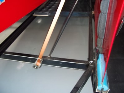

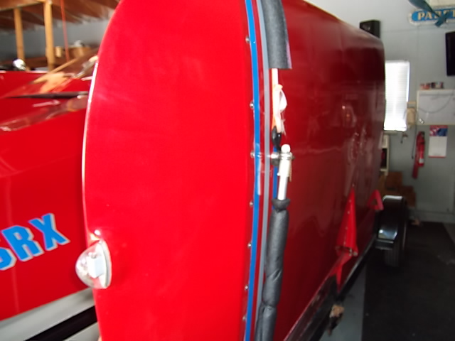

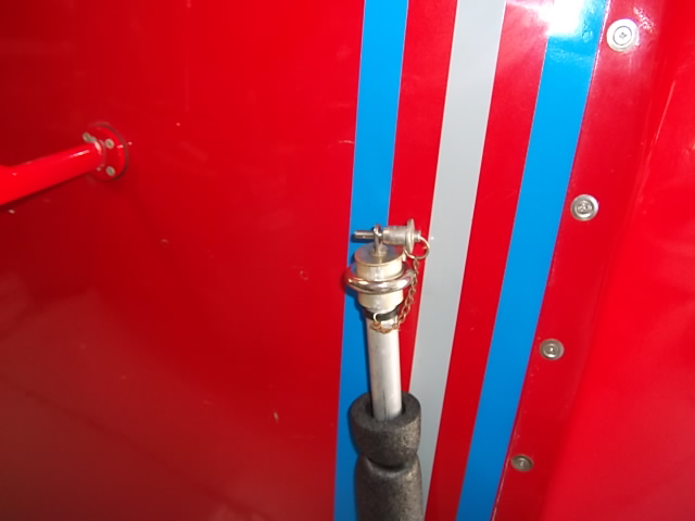

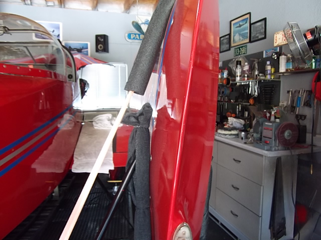

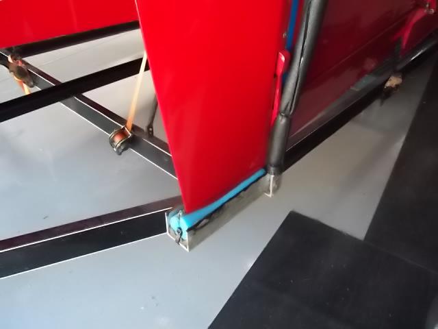

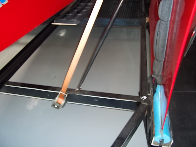

Tony...your trail is similar to mine . Should you care to add wing supports/cradles to leave the wings on I have included a few pics of my set up that has worked well for 7 years . The bottom support for the wing is a piece of aluminum channel attached to the trailer . It supports both the wing AND the aileron . The outboard tube with the pip pin is 3/4 " alum tube with and AN fitting on the top for the pip pin . The tube is bolted to the channel and swings out of the way when moving the wing . I used the wing tie down fitting to attached the outboard tube and secure it with the pip pin . The inboard support is nothing more than 3/4" steel tubing attached at the bottom with bolts to swing out of the way so the horizontal stab can clear . To secure the support in the up right position another pip pin is attached at the bottom pivot point . A 1" ratchet strap is secured over the wing to snug up the whole operation . Trailer has been down the freeway at 55 mph with no problems (except the lookie loos !)
