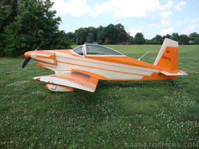

Have seen taller verticals, but probably for different reason(s).
PostPosted: Sun Oct 28, 2018 1:19 pm
The taller vertical was to house a comm antenna that was popular in the day.

Ah, the stabilator, thanks John. That V-tail just made me think about "other mods." That's in interesting pic with the large vertical fin.
