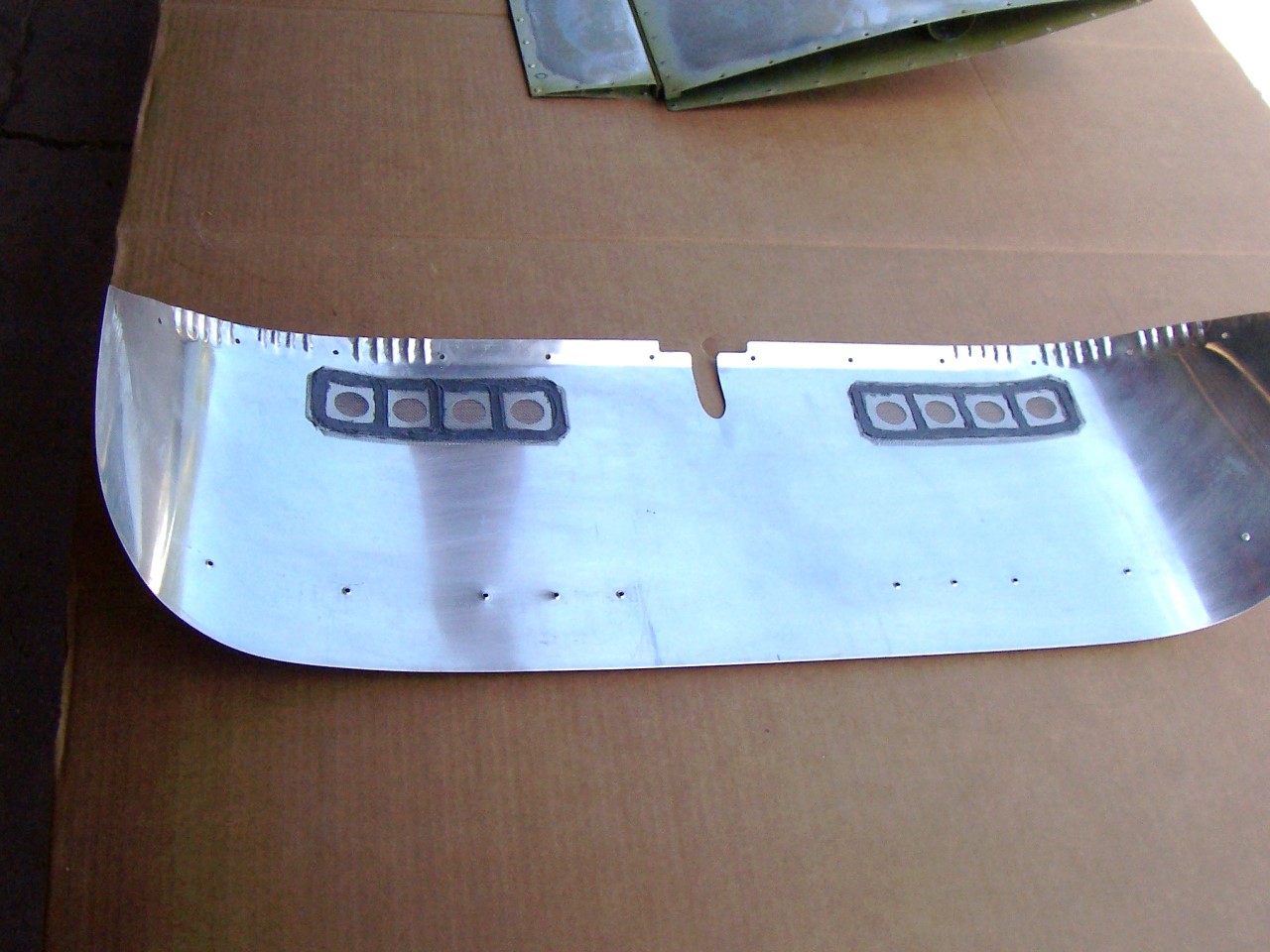

Try fluting the forward edge of the glare shield and use it to secure the bottom of the windscreen behind the skin with a chaffing strip in-between. This takes care of two things at once. It should be a bit flexible as the instrument panel will bounce using vibration isolators. It was easy to add holes covered with screen as a sort of window 'defroster.' Cabin heat and that from inside the firewall will typically find its way upward. It also helps circulation for the radio and instruments.
Les
