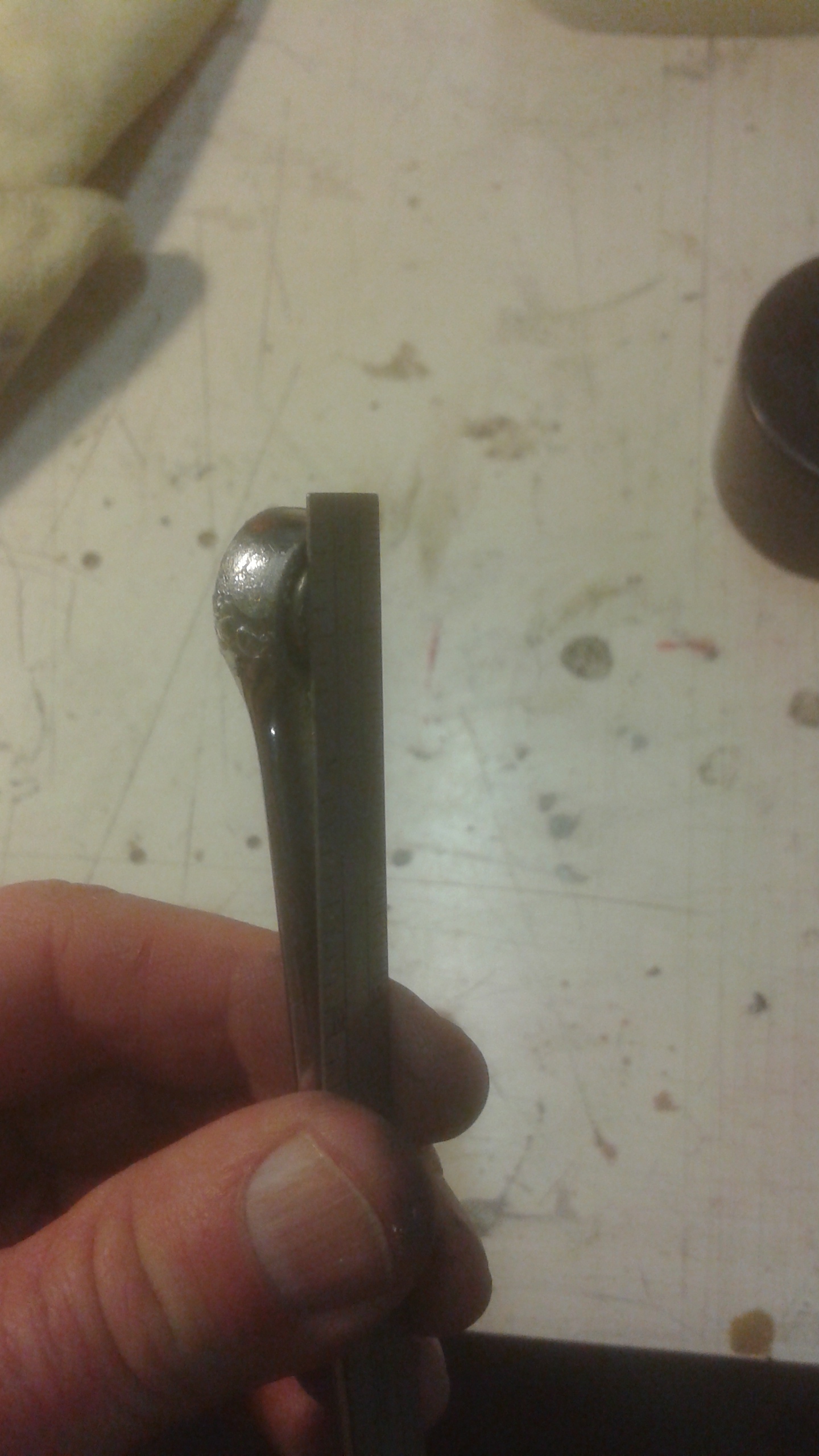

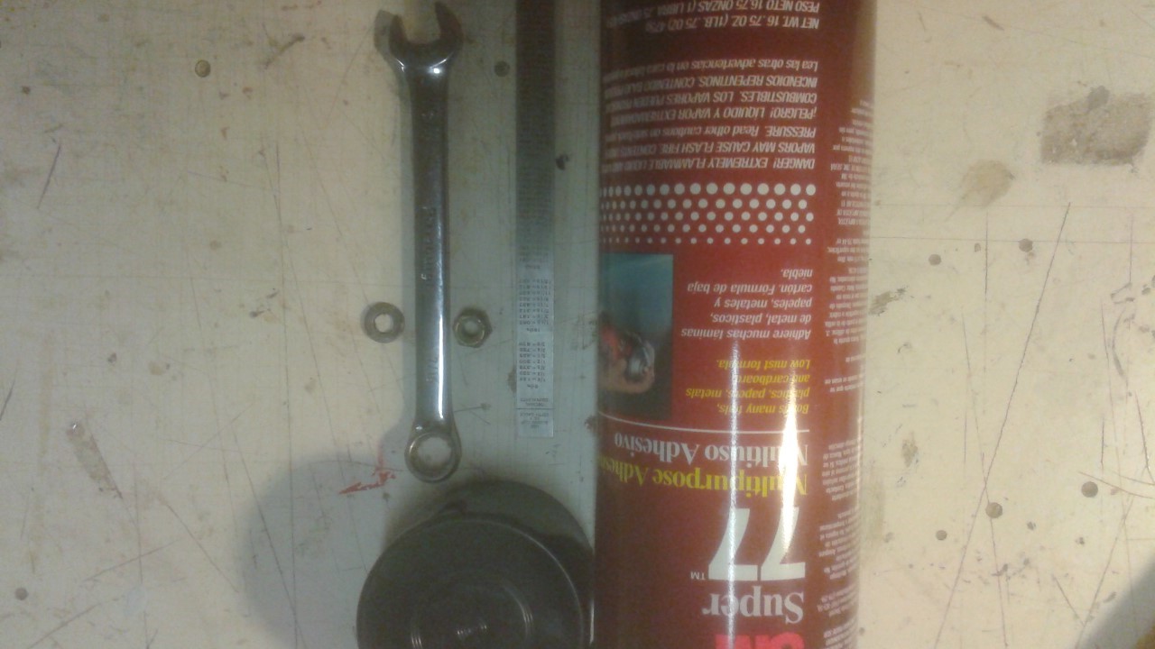

I changed out the 594 stabilator bushings while down in conditional today. Getting the bushings out was easy - getting the bushings greased and pressed in was easy......lining up the holes with a wood dowel pry bar and getting the bolt back in was not too hard, but how to get that nut and washer back on made me think for a minute.
A little 3M spray adhesive on the wrench and the face of the washer kept the nut and washer in the wrench. then just putting a thin piece of metal on the backside of the wrench so the nut won't push out the backside, and sneaking it up under the stabilator into the small opening with the bolt just barely peaking out of the hole, and VOILA!!...easy peasy.....wrenched it on first time both sides....slicker than a cucumber in a Halloween pumpkin!!

Good goin', Frase! Yep, ya gotta' get resourceful sometimes with these birds. A drop of super glue is sometimes helpful for sticking a nut & washer together, or a nut to a wrench when in a situation like that. I've used a piece of tape on the back of a box end wrench many times also.

Readin your post I was waiting for you to say after all that work you realized you should have used the open-end of the wrench instead of the box-end, and you know what I mean! Some places are really tight; don't ask how I know. But no worries, I don't fly with too many wrenches inside. Ha ha.
