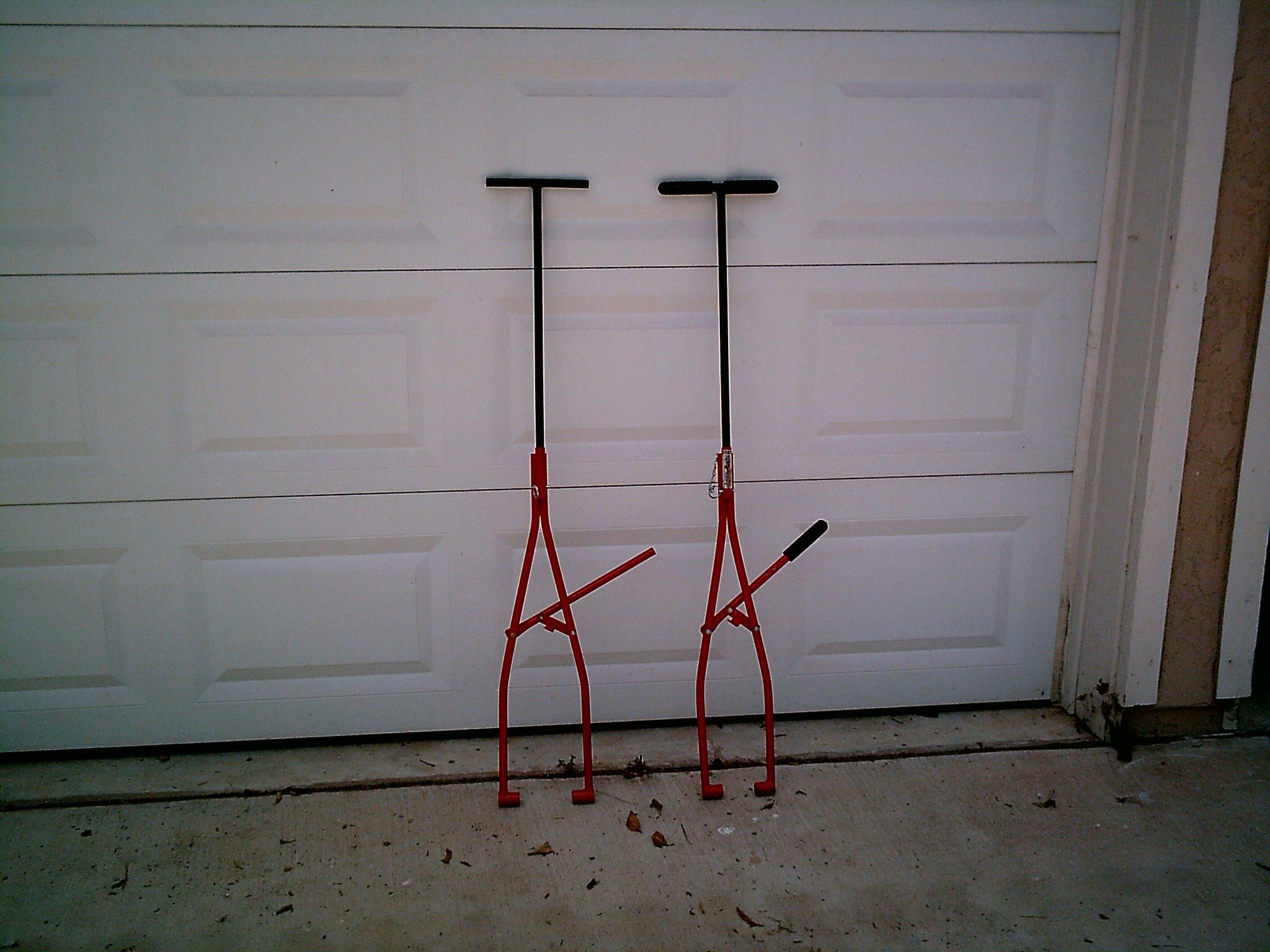

Here is my tail pull handle. Cost about 10$ and some scrap steel laying around. Handle is electrical conduit. It fits the Scott 3200 on a Citabria as well as the ACS 6" tailwheel. Probably fits most tailwheels with bolt sticking out both sides.
Bernie Fried
N18XS

Nice work as usual Bernie ! I bought one of the Bogart tow bars and after looking at it I said to my self , yo...I can make one of those ! ??? I keep one at home and modified the other one to take with me in the AC to use as a real tow bar to slipover a trailer ball or attach to a pintail hook . :P About $10.00 worth of steel tube , a few nuts and bolts and some red & black paint and my most excellent welding skills . ::) Pretty sure someone has mentioned some time ago they use a rope to gag the tail wheel and haul the sucker in !
