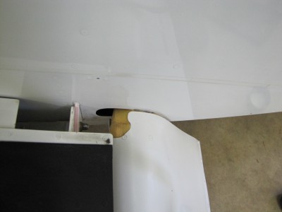

Darshan Karkey, N4MY, looked at our efforts and concluded that there must be a still simpler approach. Darshan cut a 0.9" hole in a sheet of rubber gasket material, slid it over the one inch flap actuator tube so that it is on the outside o f the fuselage, and super glued the rubber to the actuator tube. Darshan trimmed the forward end to clear the rear spar with flaps up, and trimmed the aft end to just cover the slot, The rubber just slides against the side of the fuselage, and air loads hold the rubber against the fuselage side, sealing off the slot when flaps are up.
File comment: Dick Penman's solution

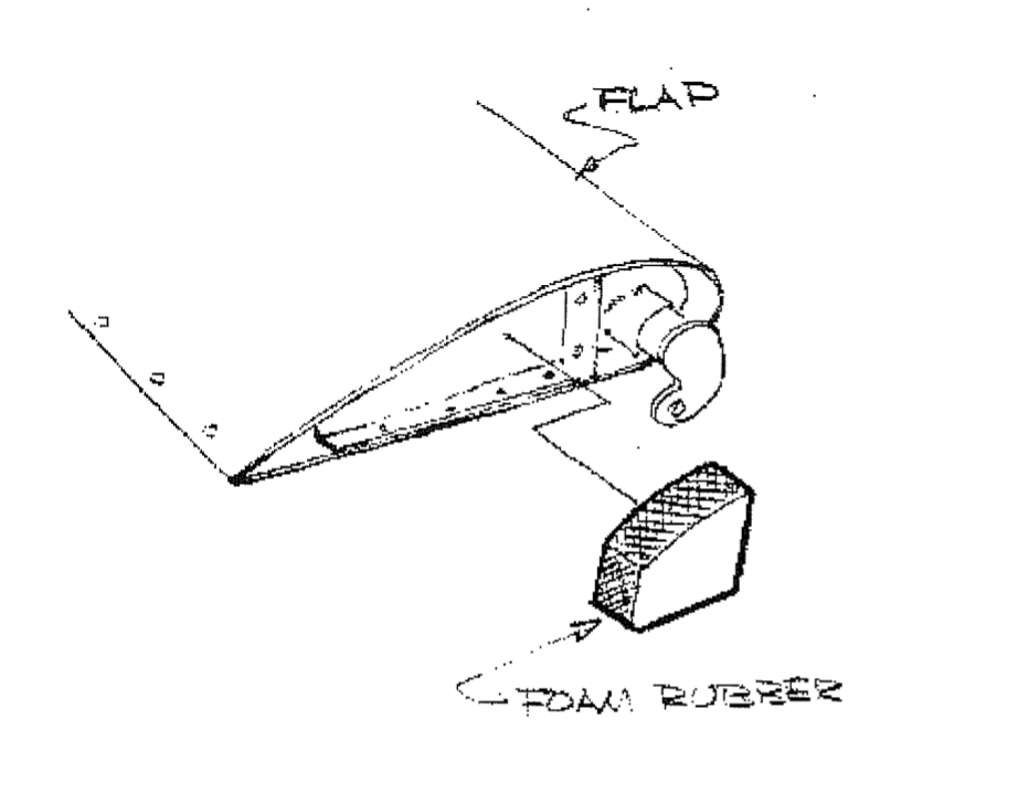

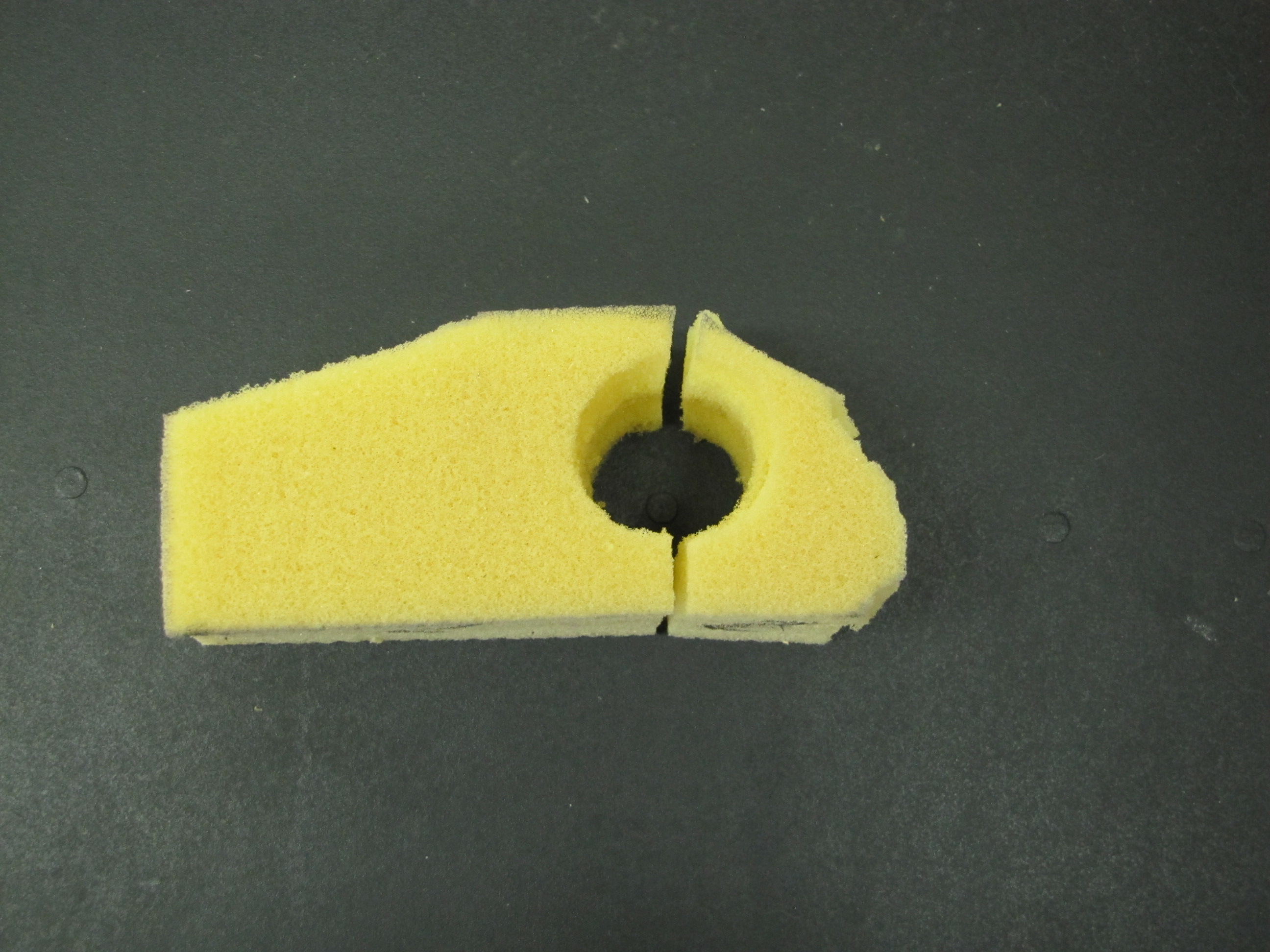

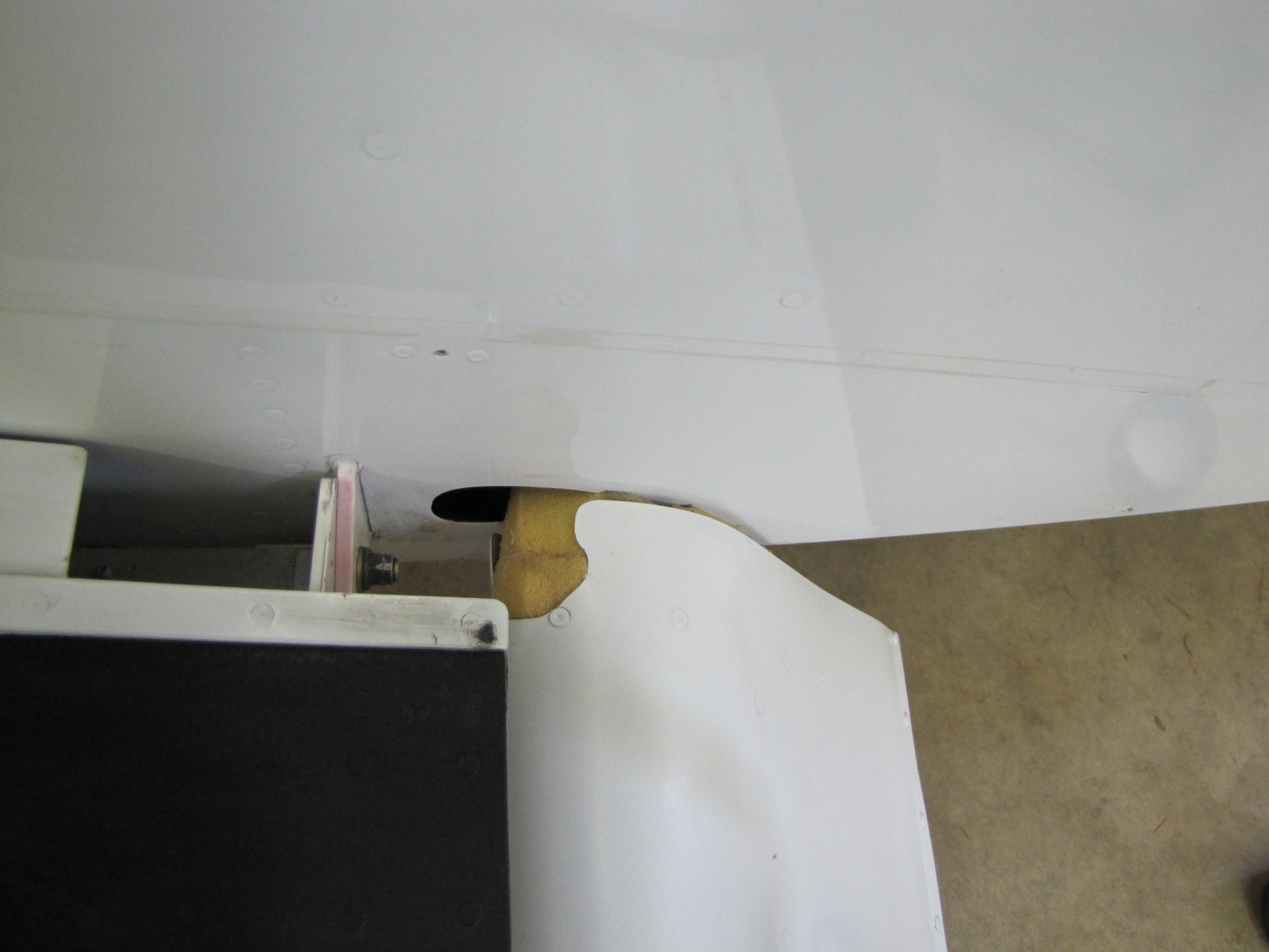

Here's my version of the flap actuation slot seal,
I use a piece of 1" thick foam, don't know what kind it was left over from a previous project. I made a template from the flap drawing -632L

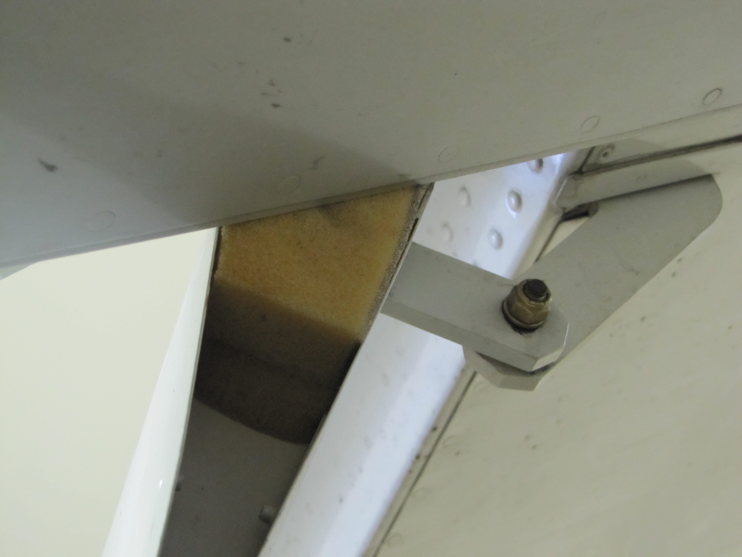

The aft portion is just stuffed up into the end of the flap by moving the flap as far down as posible, it's held in by friction, in six years I haven't lost any parts yet.

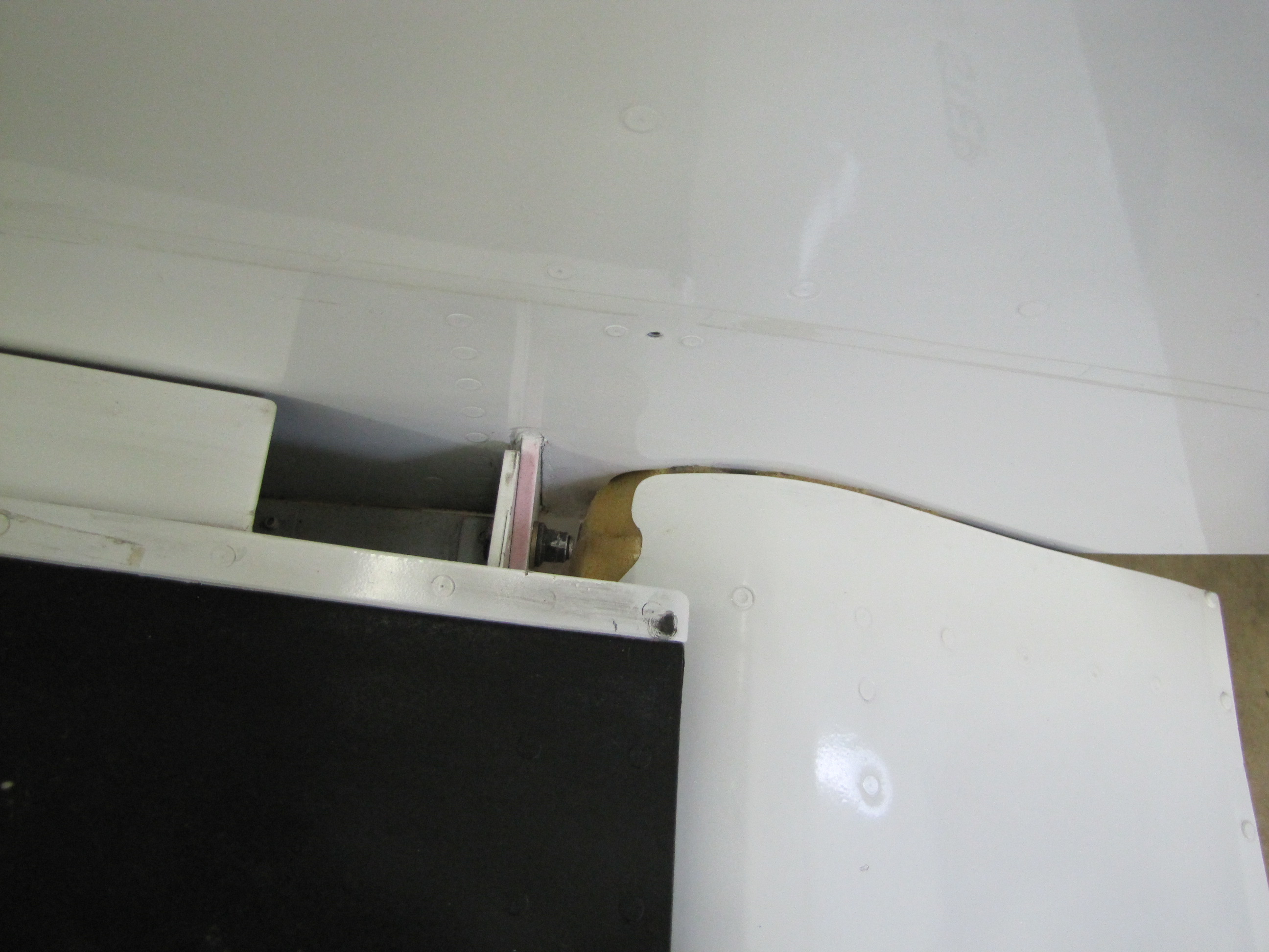

I had to remove the wing-body faring to get access to the nose of the flap and stuffed the front portion in.

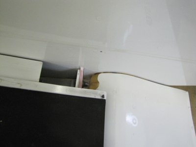

Flap fully retracted.
Does it work? yes it slowed down the amount of air coming in but I believe the majority of air is entering via the spar box from the wing root.
So far in my quest to reduce the amount of cold air in the cockpit the most effective was to place a "curtain" along the side canopy rail to slow the air flowing out of the cockpit. I used "duck" cloth (thats the stuff the original duck tape was made from) and velcro to hold it in place, don't currently have any photos will have to get out to the hangar and shoot a few.
