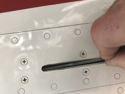

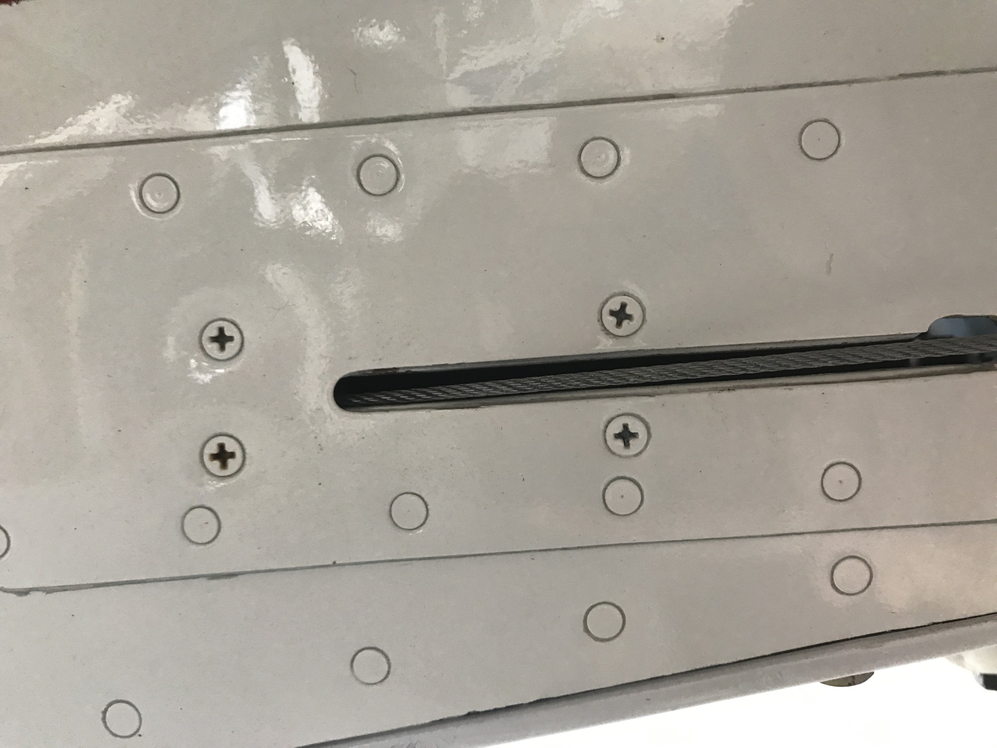

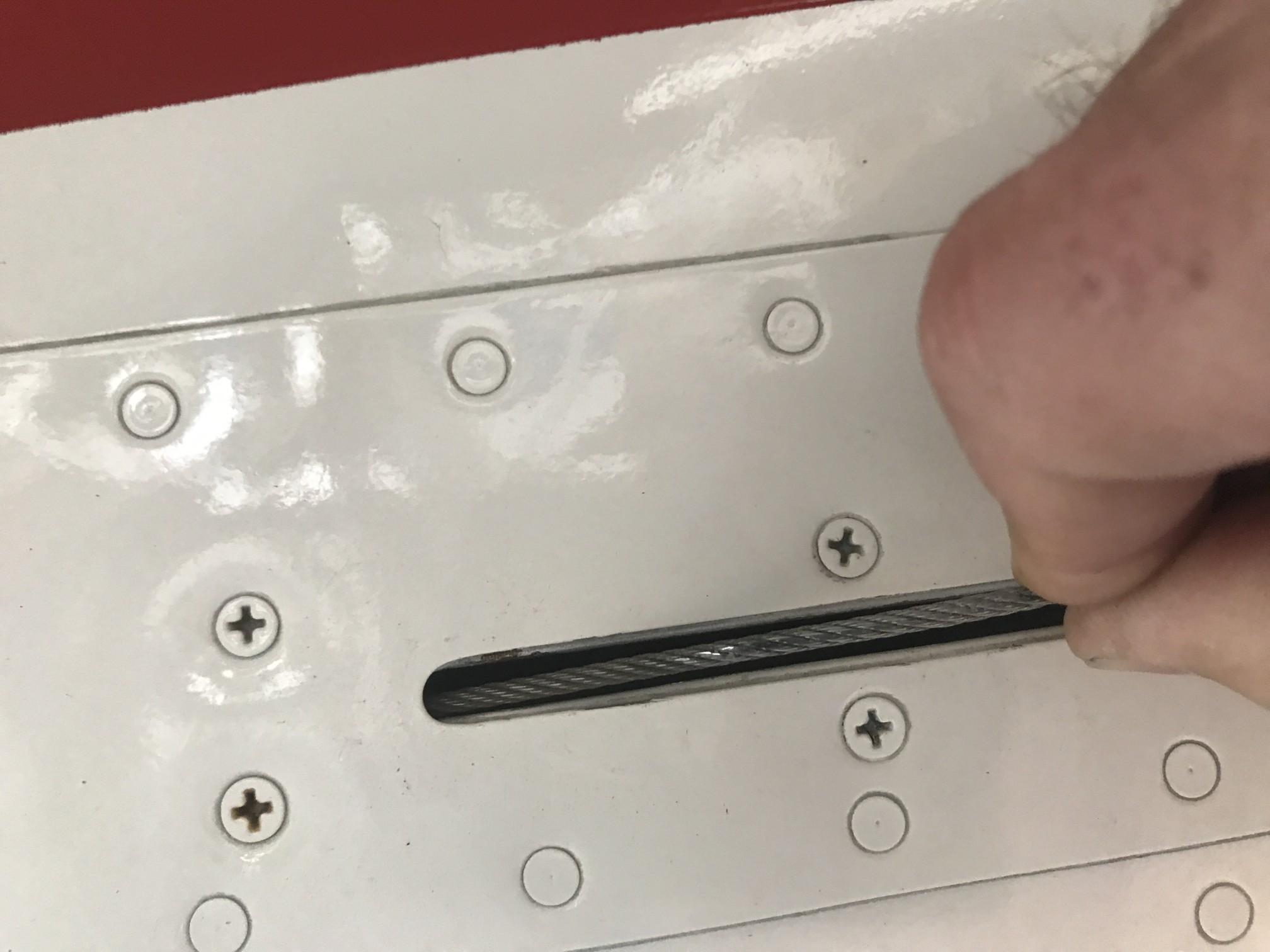

PostPosted: Sun Jul 02, 2017 8:22 pm
Cable looked pretty good at first glance. Unfortunately, glancing is not inspecting. The other side was only slightly better.
