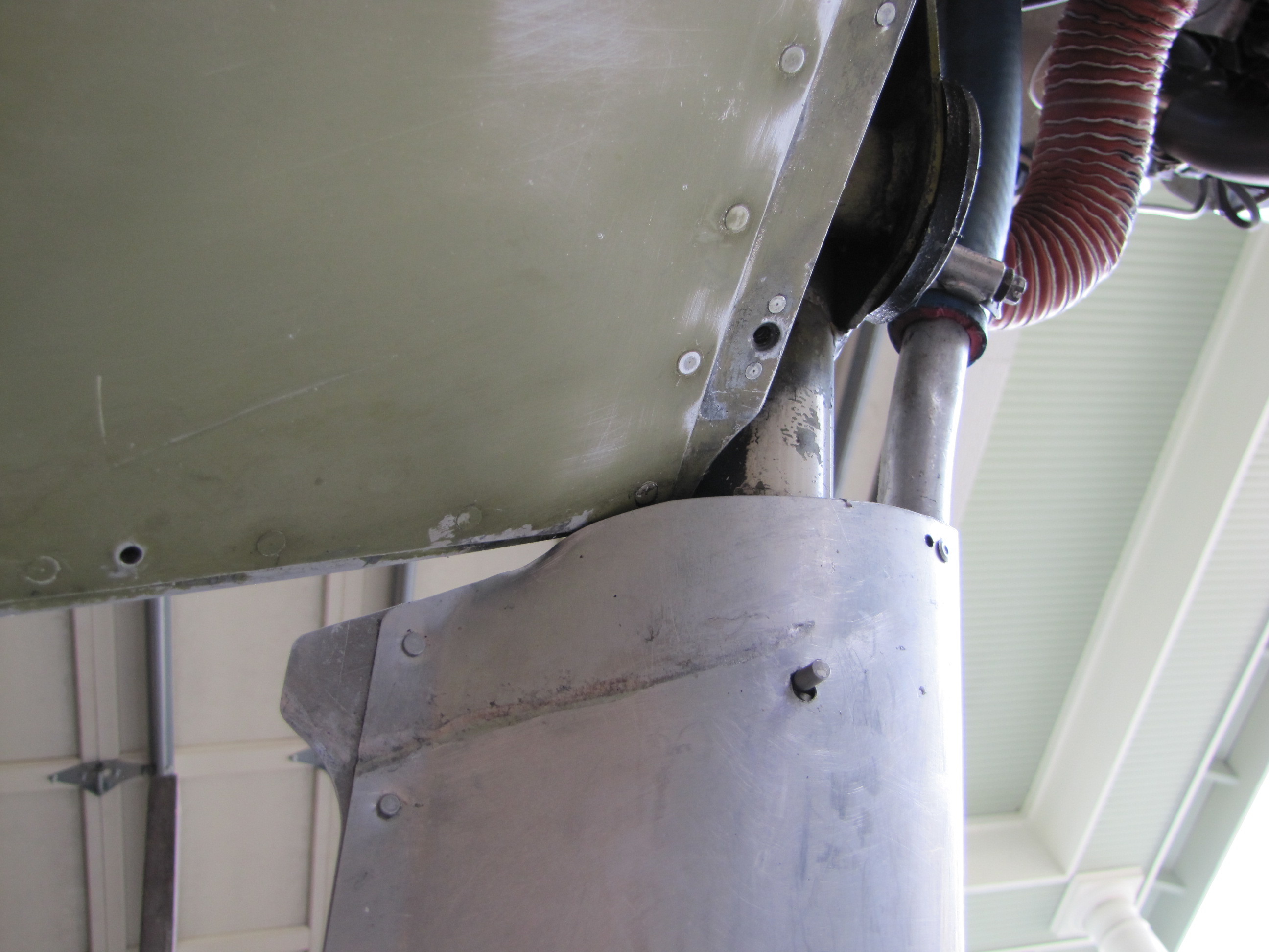

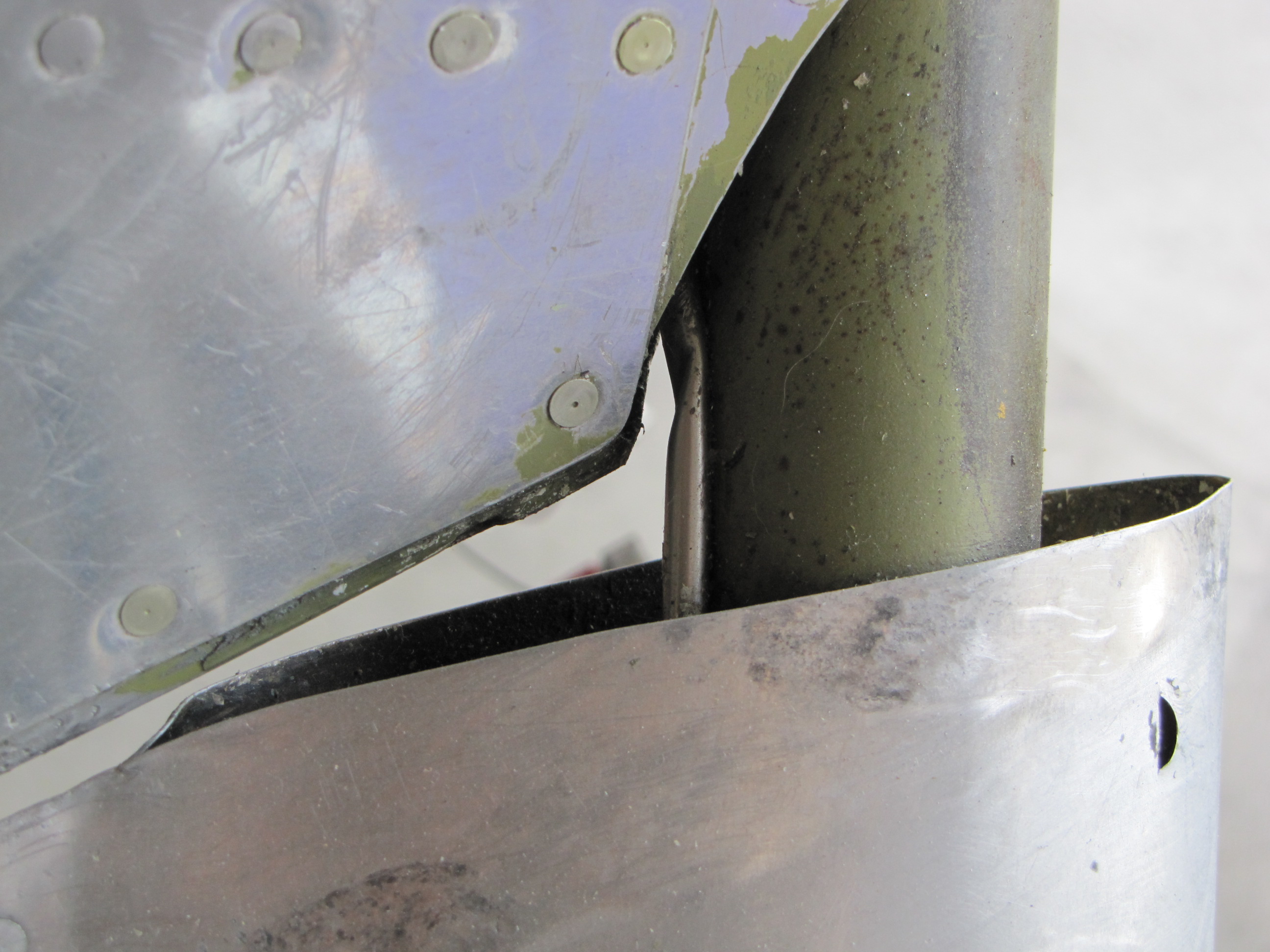

File comment: Brake line behind the gear leg.
Case in point, note brake line, there has been at least one hard landing some time in the past.
Left gear leg from under the fuselage, there isn't a lot of room to run the brake line through the floor and into the gear leg fairing. The brake lines on this aircraft go through the firewall using a steel AN833 90 deg bulkhead fitting. Large tube running down the front of the gear leg is the crankcase vent.
