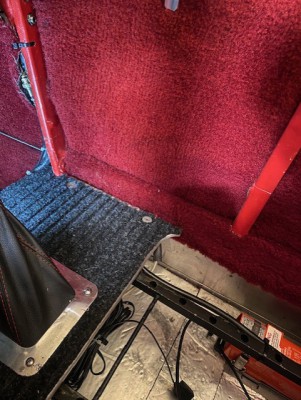

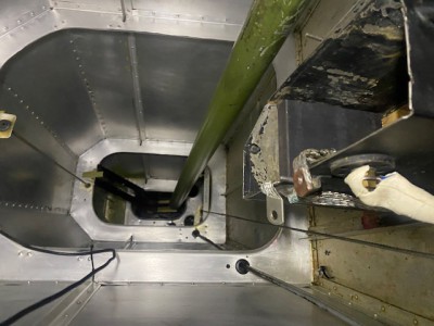

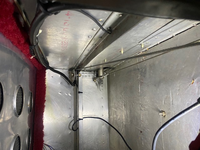

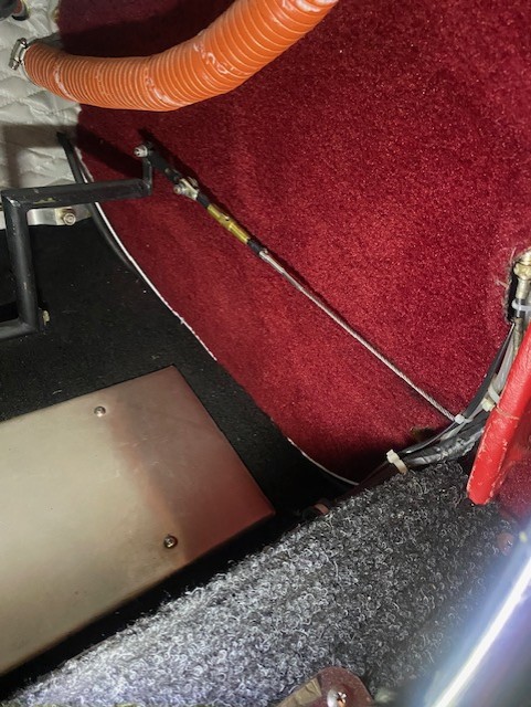

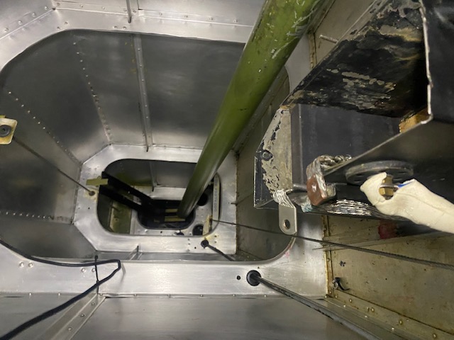

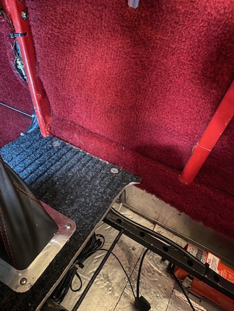

The builder of my plane, Fred Gindl was a good friend of Bob Dial's and he had a lot of input from Bob. My plane (Serial #558) has the outboard rudder cables. It follows the drawing fairly close except for the pulleys at the dash. My plane has a fairlead there instead of a pulley. The side of the plane from the firewall to the seat back is pretty much a straight run so a fairlead works well. From this fairlead, the cable is within a 1" x 2" enclosed cover running from the dash to the seat back. Just behind the seat back there is a pulley set. My baggage floor is raised up and this first pulley set is just under it. Hope this helps.

I tried again and it looks like a couple got rotated 90 degrees. Starting from the front there is a shot of the cable from the pedal to the fairlead at the dash. the second is the cover over the cable. The third is a shot under the baggage area looking forward from the battery access hatch. The last is the shot of the cable going backwards towards the tail.
