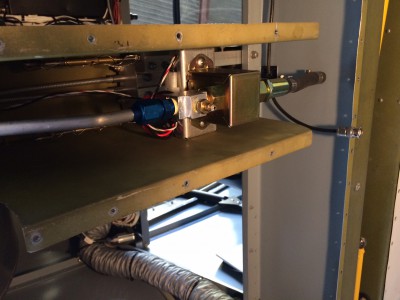

I have the same setup like you and Bob for wing tanks. A Facet pump feeds he header; I simply open the valve from one wing or the other. I also bought a Dual LM394 Module, a small circuit board for about $8 online, and connected both channels to a wire from the main sender. One turns off the Facet pump when full, the other turns on a warning light when about only 6 gallons remain, before the engine goes quiet.
For wings, I simply wanted to know when each one is empty so not to needlessly run the pump when dry. I plan on alternating each wing and timing each draw, as others mentioned. The sensor is simply a small Neodymium magnet in a float, captured in a vertical track on the most inboard rib (bottom end) of the tank. Outside the rib is a magnetic reed switch, which likewise can turn on the light. No holes to drill or feed-through wiring to worry about. Magnets conveniently work right through aluminum. If anyone would like to try the same thing I have a few extra reed switches. They’re really small and free for the asking.

PostPosted: Mon Nov 22, 2021 4:00 pm
Thought pictures would help.
Besides, I like pictures and figure others may too. The Facet pump is in forward tunnel, pushing through a tube going up center of the firewall to top of main tank. Floor panel is removable, also with access cover at center. Float can be seen in other photo, and pickup tube with screen.
Les
