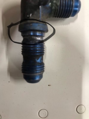

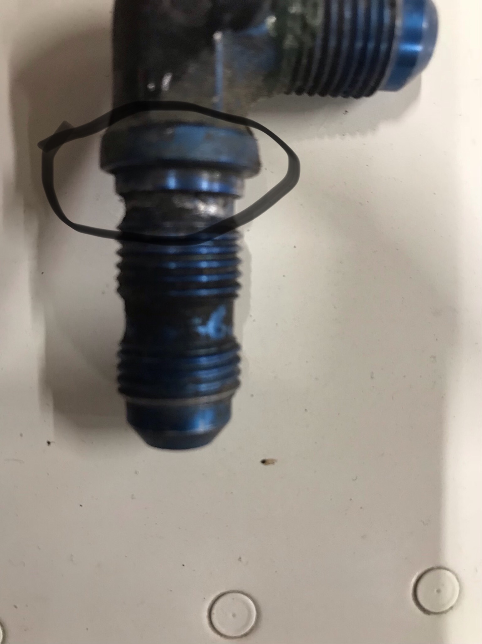

Well... I thought I had fixed the fuel leak by tightening the fitting, but I came back two days later to some fuel spots under the belly in the same spot.
Rich, this is what I meant by spiral tubing from the tank. It's solid tubing that loops twice after the fuel tank outlet before going into the center tunnel. Image
Here's where the fuel is leaking: There was fuel pooling at the bottom of the blue elbow. I tightened the nut, cleaned up the fuel, and watched it for a few hours the first time.
Here's another view of the center tunnel with the left side removed.
I haven't taken apart the center tunnel since it re-leaked, so I'm not certain that it's leaking from the same location.
If it IS from the same location, any suggestions on how to resolve the leak? I already tightened the nut quite a bit (is there a torque spec?). Do I need to replace the elbow fitting?

My first guess would be a crack in the flare of the aluminum tubing . ??? There may also be a small burr on the aluminum tubing or AN fitting . I used flexible fuel lines covered with a stainless steel sleeve . Guessing wont fix it , I would take out the fuel line and fittings where the leak is suspect for a closer look . :o
 Post subject: Re: Fuel Leak From Belly
PostPosted: Fri Dec 28, 2018 8:40 pm
That elbow looks like an o-ring adapter... there is probably an o-ring under that nut that may need to be replaced. At the very least the fitting should be removed and the o-ring replaced, as well as inspecting the surface that it mates against on the pump. When you say that fuel was puddling at the bottom of the elbow, I assume you mean where it connects to the pump. If you go here - https://www.anplumbing.com/adapters/o-ring-port-adapters.html, and scroll down a little you will see what I think you probably have. The connection at the top, or outlet of that fitting looks kind of funny also... the aluminum tubing where it exits the flare nut doesn't look good in the picture.

Are those fuel pumps flared internally or use a pipe thread? That elbow looks like a flared bulkhead fitting to me. https://m.aircraftspruce.com/catalog/hapages/an833.php
If the pump has pipe threads and I am correct about the fitting, a person would have a tough time getting it to hold fuel for very long. And the correct fitting would be https://m.aircraftspruce.com/catalog/hapages/an822.php
One of John’s would work too, maybe better, but I don’t think that is what you have.

JIC fittings require an aircraft flaring tool on the solid lines. It is very common for people to think they can use a regular flare tool. It doesn’t work. I would replace those solid lines. You can either buy an aircraft flare tool, or use flexible lines that are professionally built.
At a minimum, remove and inspect all of those fittings. I had an airplane come through my shop that had 11 cockpit fuel leaks!!! Please don’t fly until those lines are fixed!

That looks like a good candidate for an upgrade to Teflon lined hose.You can buy the hose & fittings at Summitracing or Jegs and make the assembly yourself, then it will actually fit.
I’m pretty sure it is what I suggested... I think that those Dukes fuel pumps may use that kind of an o-ring adapter. It is not a tapered pipe thread nor internally flared... it is a straight thread. It allows the fitting to be clocked at whatever angle you want, then locked down & sealed by tightening the nut and compressing the o-ring. It is not an uncommon type of fuel fitting. He should be able to tell if the leak is there or on the flared connection. Since he said that fuel was puddling at the base of the fitting I suspected it might be that.
Good advice. 45 deg. flaring tools are common in the plumbing & pipefitting trades. You want a 37 deg. tool... common also in the automotive field.

jrevens wrote:
None of the fittings in your link has the shoulder for riding in a bulkhead but the one on his pump does. Someone may have tried to convert a bulkhead fitting to work by cutting off the flare and/or installing an o-ring but that shoulder says bulkhead.
