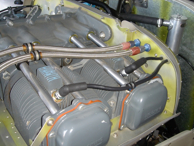

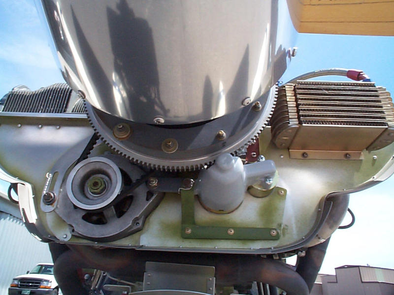

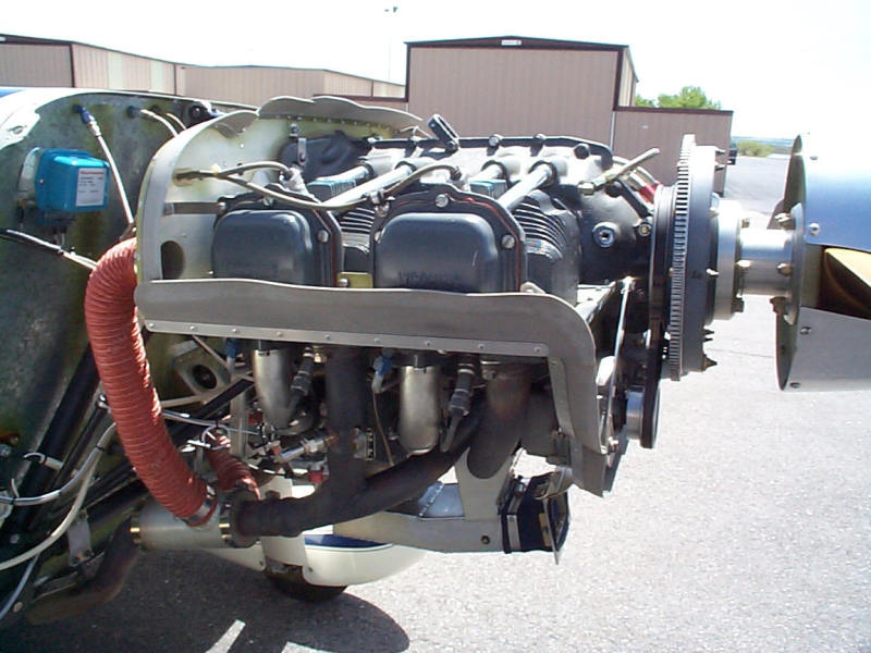

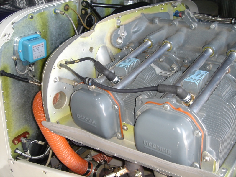

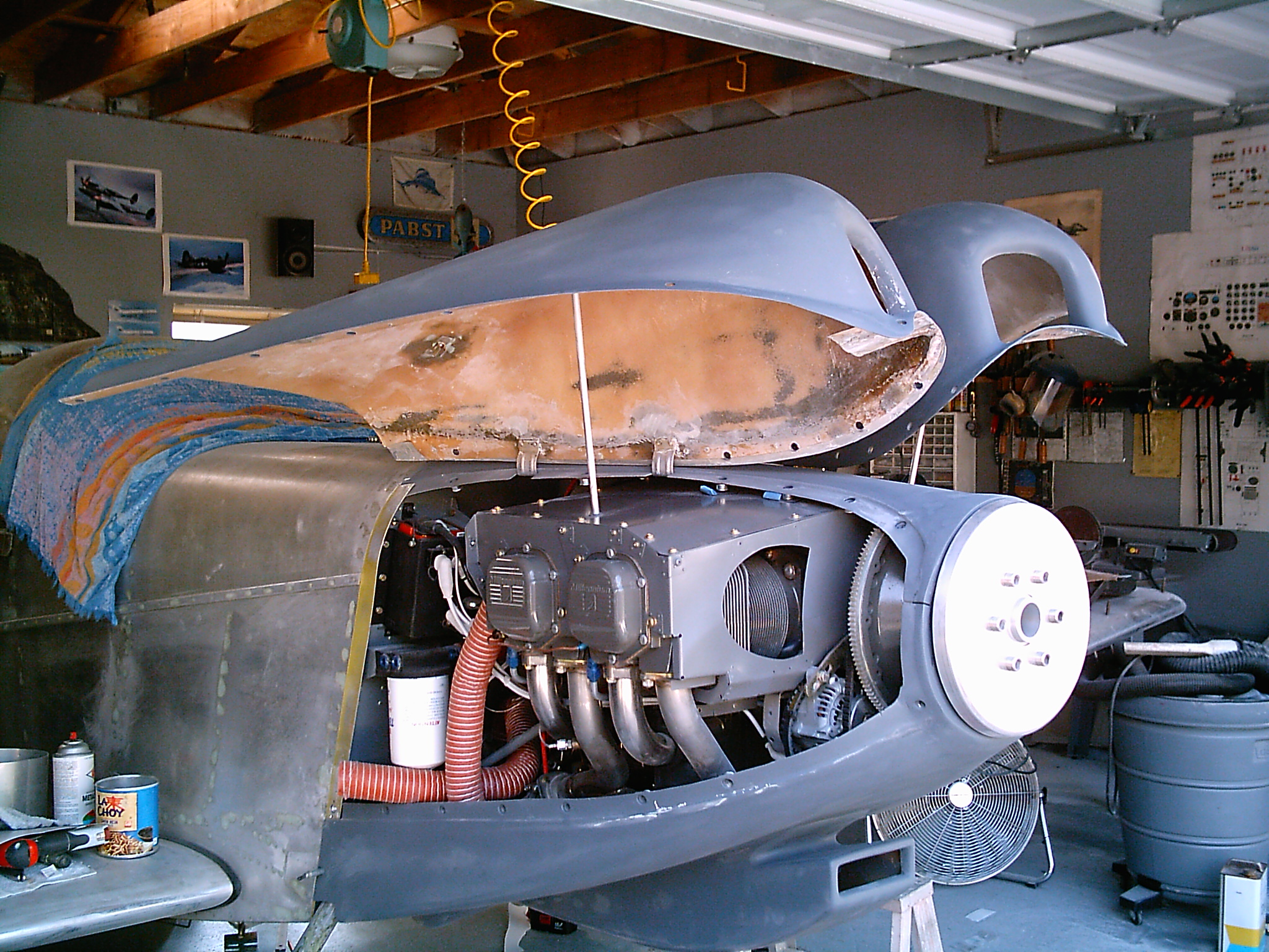

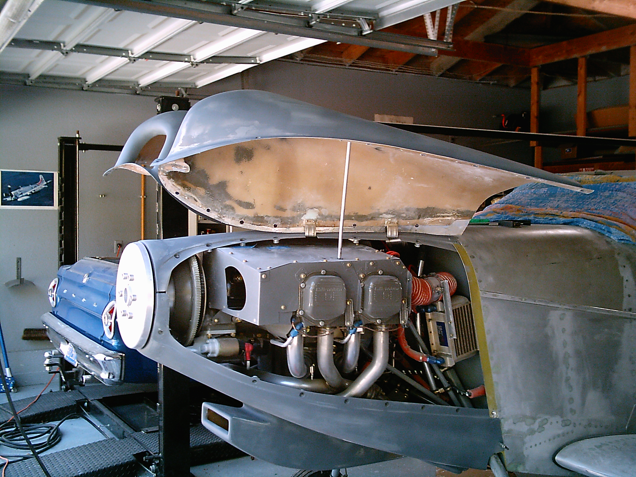

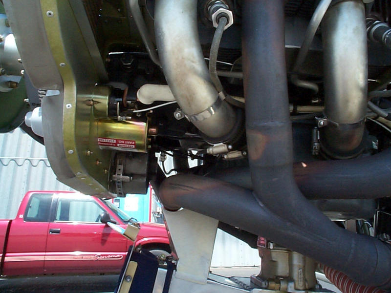

I thought I'd post a few pictures of my baffle set-up, after receiving a request. I've got so many pictures of engine detail that it's hard to pick to show specifics you might be interested in. I used a thin (1/16") grey silicone rubber when, as far as I know, no one was using silicone for that. I used mostly 6061-T6, and made wooden form blocks to form the flanges, annealing as necessary. Maybe I just got lucky, but I've never heard of anyone on this forum measuring CHTs that were any closer together than what I have measured on mine, and I have very good overall cooling too. The maximum difference I measured between my hottest and coldest cylinders was 12 deg. F. (in a steep climb), the max. difference in cruise was 8 deg. F. The maximum measured temperature during the test flight was 328 deg. F. To clarify, I have an O-320-D2A, the carburetor is an MA-4SPA (part #10-3678-32), and I did change the nozzle on it to the "pepper-pod" style (part #47-828). After a few hours of tests I decided to ream the nozzle I.D. @ the inlet to 0.104" from the original 0.093". This was done late in 1995, and the test flight measuring temperatures was in 1997. I don't have an engine monitor, but I used 4 bayonet-style probes, and ran the wires in through the cabin heat box to an electronic digital thermometer on the seat next to me. All pretty "old school" compared to today.

Can you post pics of the intake of the cowl and exit? Do you happen to know what ratio of difference it is?
Also, it appears that even your valve covers are in area of ram air. Are there any block off plates to force air into the cylinders instead of around the valve covers?
Maybe more airflow in and out is the key. Yours looks very open with lots of flow even if it isn't 100% forced into the fines. Maybe that keeps the air from backing up in the cowl and holding heat in.

It's actually not at all "open", and almost 100% of the air is forced over and through the cylinder fins and out the bottom. That's one of the things that make it efficient. There are very few, if any, air "leaks". You can see the silicone material that runs along the sides at the rocker box covers. That is attached to aluminum pieces that closely follow the contour of the engine. The following picture shows that. This is basically John Thorp's original design.. it's very tight and efficient. It was taken when I had P-Mag ignition units along with the automotive style spark plug wires. I went back to mags sometime after that.

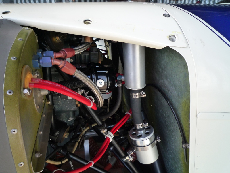

Here are a few other pictures... I don't have much showing the air intakes and outlets on the cowl.
