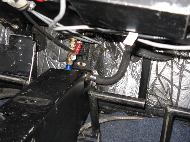

I have to pull the fuel tank to fix an unrelated problem but while I have it out I figure I might as well open this can of worms too. I would like to make the fuel shutoff a little more user friendly and run the line forward in a straight line though the strainer to the carb. I have read posts where people only have two 90° elbows in their gravity feed system so it should be possible without too much heartburn but I could use ideas or pictures on what people are using to make it happen. Thanks.

Man, that's a frightening picture! Brass fittings and hose clamps with a kink in the hose

Yeee Doggie ! I know what I will dreaming about tonite ! :o A fuel valve you can not reach to turn off in flight (looks like the valve I have on my hot water heater ? . ??? Worm gear clamps . :P Standard issue flex hose ! :-[ A very good idea to change this out when the tank is out .
1. Move the fuel shut off valve from the bottom of the tank (plenty of info on why not to put it there) to where you can reach it in flight or install a shaft to it where you plan to locate it so it can be closed .
2. SS braided hose with AN fittings/fire sleeve or an aluminum line with AN fittings can be installed .
I used the SS braided stuff w/AN fittings attached to an ANDAIR fuel shutoff valve . A little pricey for the valve , but I like the positive detents it has for ON and OFF . Plus a well labeled face plate . Made by the Brits .

The shadow from the tape is in a bad spot. Really not very close to being kinked but it should not be twisted either. An elbow would have been a better choice than twisting the hose.
The ANDAIR valves are nice but I need help understanding how to install one while keeping the use of the detents and keeping the plumbing simple for gravity feed in the process.

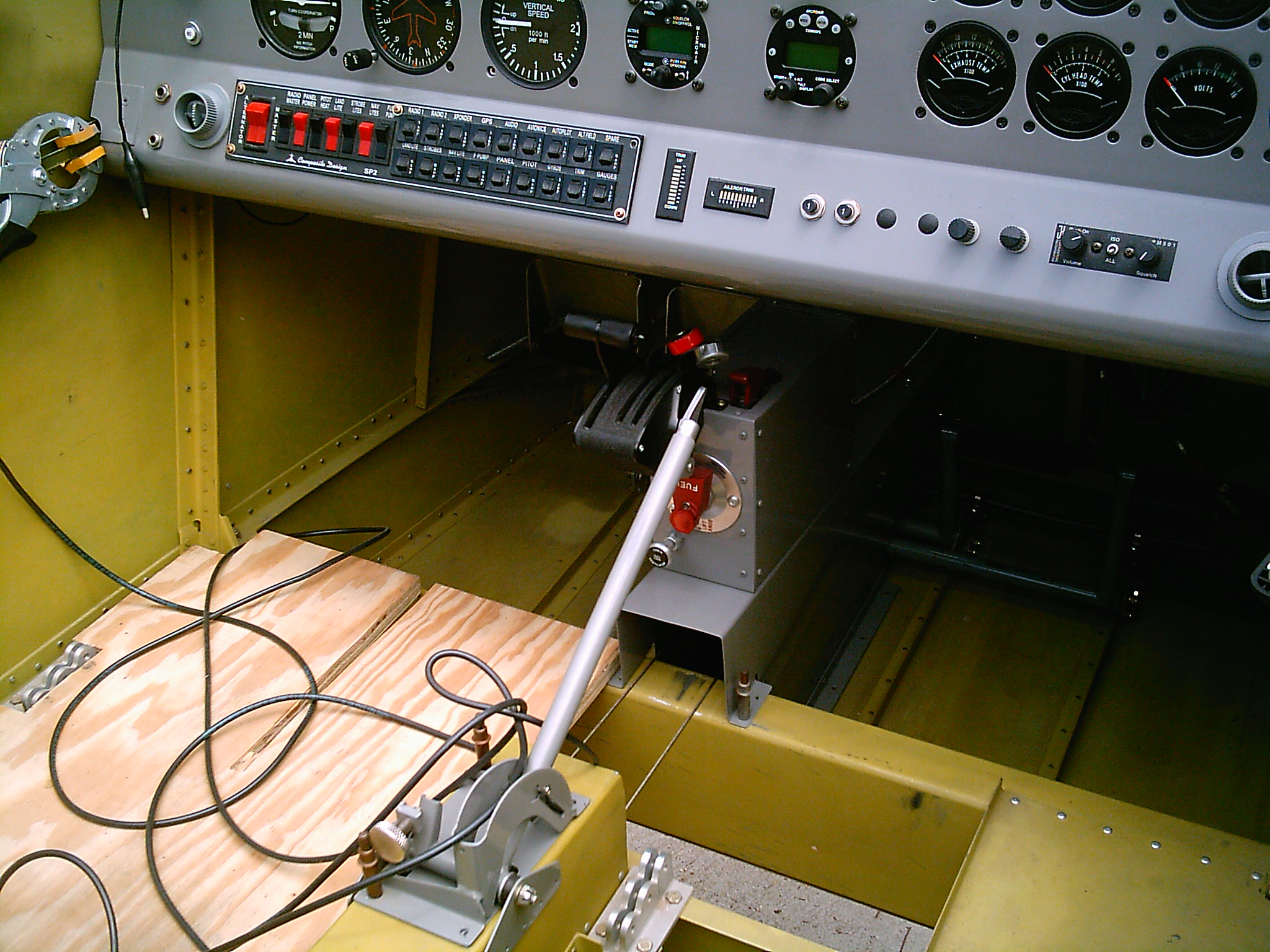

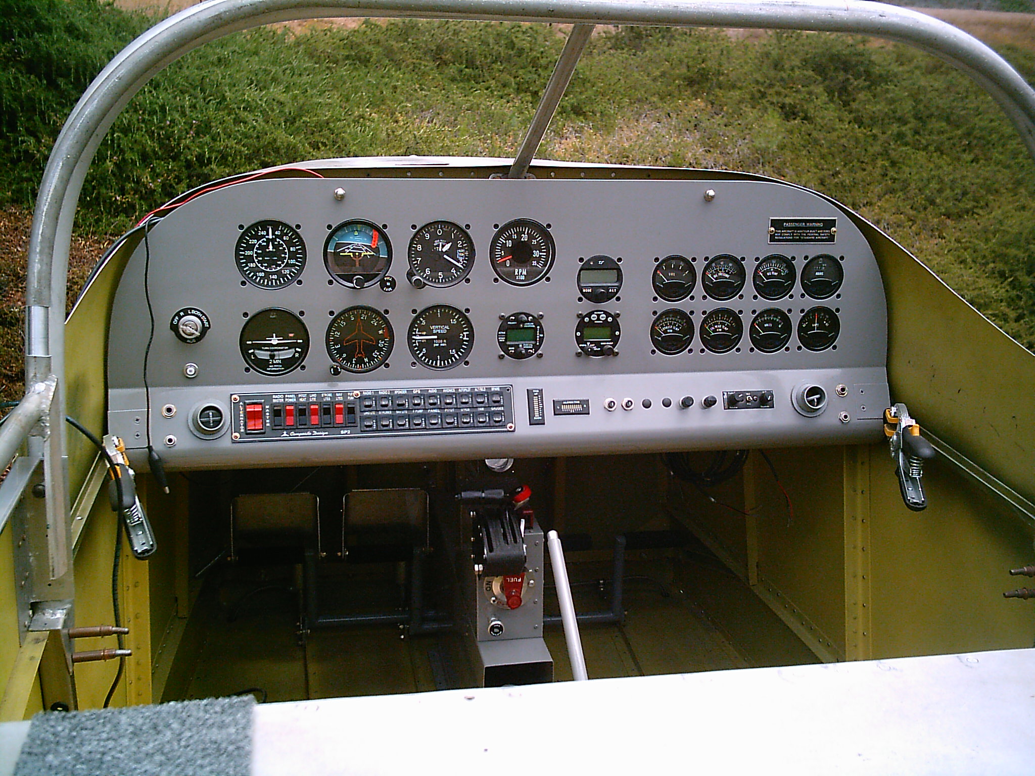

I put my Andair Valve here...
1. Easy to reach .
2. Easy to see .
Not much to hook up . :P Fuel line in , fuel line out . I have seen them mounted in various other places , but always easy to reach and see . ;) Google ANDAIR products and they have a very nice web site . I believe I got my valve from ACS ? Has worked perfectly since day one . :o
