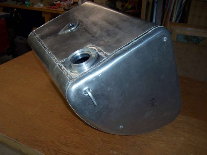

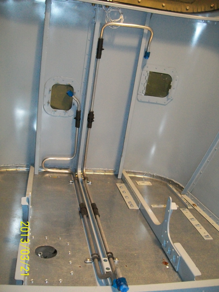

Lou,
Here's a couple of photos you can use to locate your sending unit (see hole on left side). I believe this is per plans (about midway fore/aft along top?), but it's been a while. The extra tube is for top filling from wing tanks. Logically, it's between stiffeners as you say, and almost halfway on longitude between firewall and the dash frame. Scale the photo and you'll be close enough for a starting hole. Don't drill too deep1 Ha, Ha. When you're done hacking on it, try a dentist's mirror to look around the top of the tank for chips, etc.
If you want to temporarily cover it with a plate, maybe use a few pop rivets, then tape over it against rain. Aluminum types are easy to drill out when the time comes, if you first pop out the mandrel. Tom Hunter showed me once how oval holes allow you to insert oval doublers underneath the skin from outside.
Hope this helps,
Les
