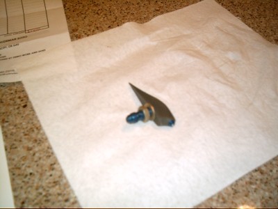

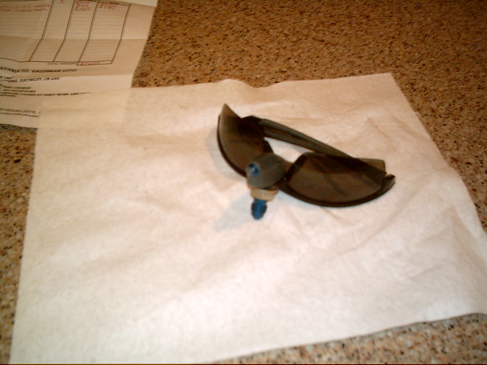

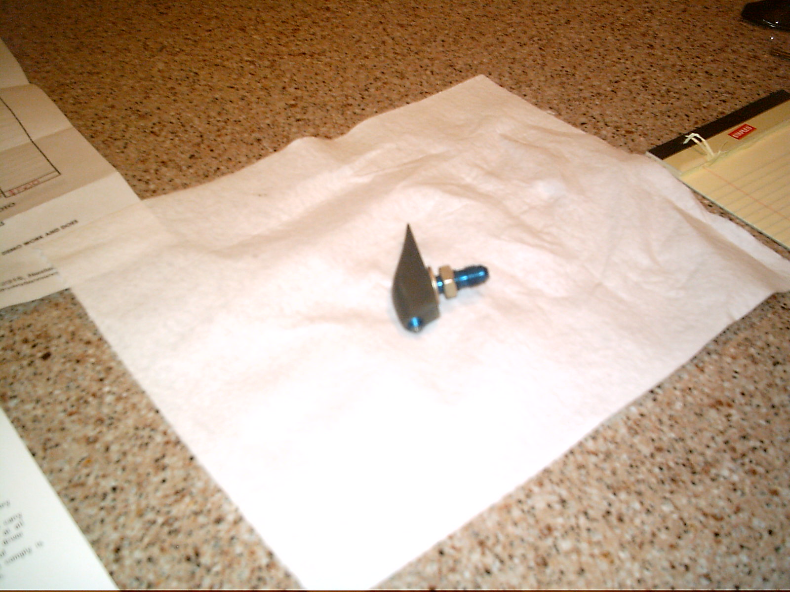

You mean something like this ? Got it from http://www.aircraft extras .com . I do not have a gravity system but this little gizmo has been on for over 200 hours with no problems . Not sure if Aircraft Extras still makes them/sells it . They may have some old stock . I think I paid $20.00 for 2 + shipping . Looks good and stays out of the way . The aero engineers can jump in here , but I don't think it takes much positive pressure to "pump up the tank ?" Sorry it is a little "fuzzy" ??? but I think you get the idea .
