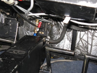

I have to pull the fuel tank to fix an unrelated problem but while I have it out I figure I might as well open this can of worms too. I would like to make the fuel shutoff a little more user friendly and run the line forward in a straight line though the strainer to the carb. I have read posts where people only have two 90° elbows in their gravity feed system so it should be possible without too much heartburn but I could use ideas or pictures on what people are using to make it happen. Thanks.

Man, that's a frightening picture! Brass fittings and hose clamps with a kink in the hose

Yeee Doggie ! I know what I will dreaming about tonite ! :o A fuel valve you can not reach to turn off in flight (looks like the valve I have on my hot water heater ? . ??? Worm gear clamps . :P Standard issue flex hose ! :-[ A very good idea to change this out when the tank is out .
1. Move the fuel shut off valve from the bottom of the tank (plenty of info on why not to put it there) to where you can reach it in flight or install a shaft to it where you plan to locate it so it can be closed .
2. SS braided hose with AN fittings/fire sleeve or an aluminum line with AN fittings can be installed .
I used the SS braided stuff w/AN fittings attached to an ANDAIR fuel shutoff valve . A little pricey for the valve , but I like the positive detents it has for ON and OFF . Plus a well labeled face plate . Made by the Brits .

The shadow from the tape is in a bad spot. Really not very close to being kinked but it should not be twisted either. An elbow would have been a better choice than twisting the hose.
The ANDAIR valves are nice but I need help understanding how to install one while keeping the use of the detents and keeping the plumbing simple for gravity feed in the process.

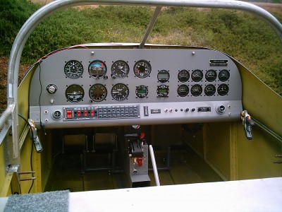

I put my Andair Valve here...
1. Easy to reach .
2. Easy to see .
Not much to hook up . :P Fuel line in , fuel line out . I have seen them mounted in various other places , but always easy to reach and see . ;) Google ANDAIR products and they have a very nice web site . I believe I got my valve from ACS ? Has worked perfectly since day one . :o

Hmm...much of the same "info" you referenced above concerning the evils of having the valve mounted on the tank also talk about having as few 90° elbows in the line as possible in a gravity feed system. I also seem to recall something posted about using as short of a run as possible. Some of that info also talked about how adding fuel pumps actually decrease reliability (more failure points). There was more than one testimonial about how having the shutoff valve mounted like mine hasn't cause them a problem in 40 years. The recurring theme was "KISS".
While what you have is a very pretty setup, I cannot see your lines and it seems to me like your setup would add two 90° elbows and you definitely added length to the run. I believe it was Lee Walton who posted he only had two 90° elbows in his setup. Elevation of your valve in relation to mine is irrelevant since everything to the strainer should run downhill even when the tail is on the ground. If it doesn't then it isn't any better than what is in the picture I posted above since condensation will pool at the lowest point along the route. What did yours do when you gravity tested the fuel flow?

Rich, your system is a good system (that is a control cable clamped to the tunnel...right?) and I did not mean to imply anything else (I think I saw a drawing of one similar in a news letter). If I was building I would likely go that route but what you don't seem to comprehend is I am not building or rebuilding this airplane. I bought this aircraft to fly so I am looking for suggestions that actually promote that goal. If I can't have the airplane back together to fly in half a day I prefer not to mess with it. Removing the tank is likely to break that rule but I can't let the oil pressure line keep chafing on the firewall. While I am in there with, room to work, I am going to do something with the fuel lines and valve but I don't have a pedestal on my tunnel and my pitch trim wheel is forward of my flap handle (where I can barely reach it). I am not going to turn it into a major project I don't have time for so KISS is the order of the day and mounting the ANDAIR valve or similar within arms reach is not simple in this case.
