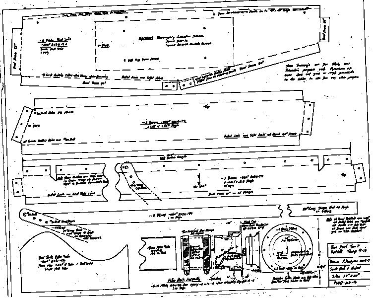

Following are designs for rear baggage compartment fuel tank.
Enjoy,
Brad
