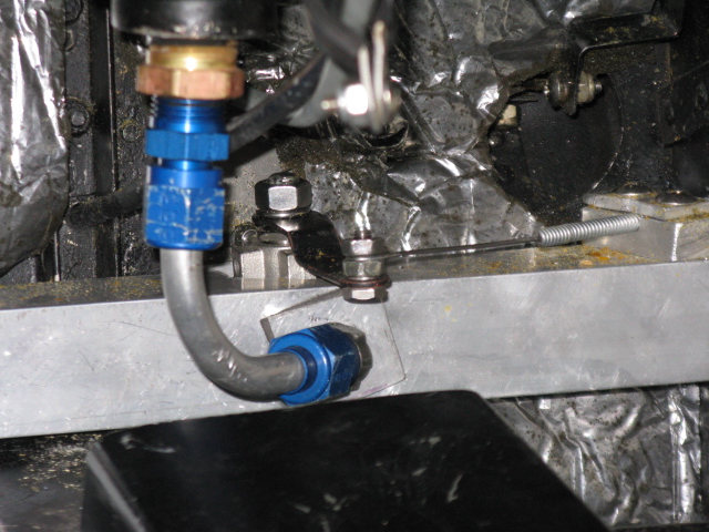

Here is the cleaned up routing. It could be prettier but there is no place for water or debris to get trapped and it flow checks better than what used to be there. I had to lower the strainer 2 inches to maintain a downhill slope from the tank. It would have been easier to make the connections as I went but, given the limited space, I mounted the components first then tried to make the connections. I couldn't find a routing for hose that wouldn't kink or interfere with the rudder pedals AND maintain the downhill slope. Time will tell if it is a lasting solution.

Simple. I like it. Is that a finger screen?

The brass fitting is the large finger screen Aircraft Spruce sells. It originally had a bushing and the small screen. I gained a badly needed half inch or more by switching screens.
