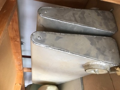

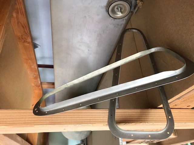

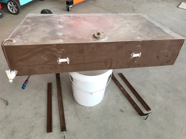

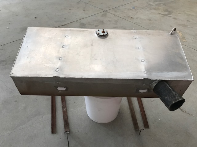

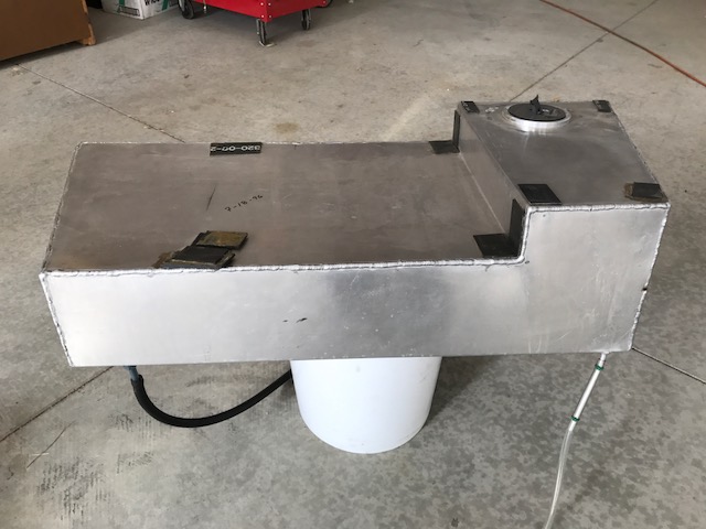

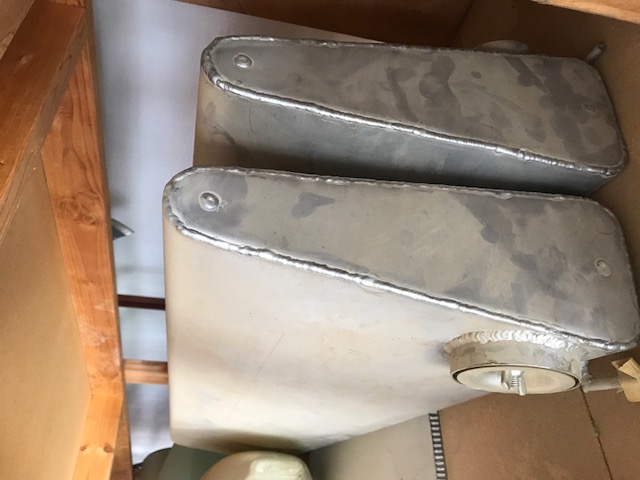

I put 9 gallons of fuel behind my shoulders in the upper part of the baggage compartment. Gravity fed straight into fuel selector, no extra pumps. I have taken my T-18 on two week trips with full camping gear for two and have not had issues with lack of baggage capacity. I pack like a backpacker, light-weight everything, so that helps. And of course, I empty the Aux as soon as I get to cruise altitude. My wife and I easily made it from So Cal to Denver (700+ miles) with fuel to spare (O-320, 180hp, Ellison TBI EFS-4, ElectroAir Electronic Ignition System).
Here are some pics of my 9 gal aux tank, a donated larger upper-baggage aux tank, and a set of 9 gal Outboard Wing tanks for when I build another set of outboard wings. (After previewing -- Pics are reverse order, last loaded show up first.)

File comment: And the ribs to support the wing tanks.
File comment: Here are two "standard wing" Outboard Wing tanks that are 9 gallons per side.
File comment: Forward side if the larger tank. Same SS type tank straps as the main tank.
File comment: Here's another version of an upper baggage tank. I think it's 10 or 12 gallons and the filler is on the hip skin behind the tank.
File comment: Thicker in the back. This tank is easily installed/removed as needed.
File comment: Front side of my 9 gal aux tank. Filler is on the deck behind the passenger's right shoulder. Front is thinner than the back so loading baggage is not hindered.
