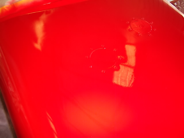

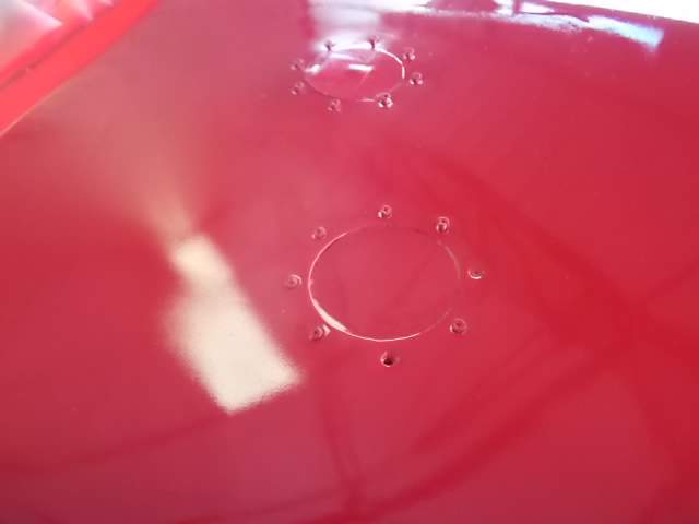

PostPosted: Fri Apr 14, 2017 2:26 pm
Here you go Mr. Lou...pics of my fuel sender access cover . A little tuff to see in the one pic as I am doing touch up painting. :o
1. Diameter of cover 3 1/16" .
2. Distance between screws 1.5 "
3. Material same thickness as the cowl . 0.032 ?
PostPosted: Sun Apr 30, 2017 6:52 am
That looks like good work but it appears to me like the panel drops out to the inside of the aircraft in a hard to reach place. Is that actually the case?
PostPosted: Sun Apr 30, 2017 8:07 am
Short answer...yes/no . ??? Remove screws , slide cover to the right to expose the SU . Do your business , then slide the cover back to the hole . Lift into position and replace the screws . :P BING BANG BOOM !

PostPosted: Thu Feb 14, 2019 1:16 pm
Update;
The irregular cover shape is partially because of the stiffener under the skin on the port side (right side in top pic). The doubler has a joggle to lay under the angle stiffener to add strength. Those rivet holes are machine countersunk, the others are dimpled. (except the plate-nut rivets, they are countersunk too)
The size of the sender unit flange dictates the size of the opening in the doubler plate and wider rivet spacing.
A bit more work to do on the cover...
