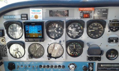

 Post subject: Re: GARMIN G5
PostPosted: Fri Feb 23, 2018 5:30 pm
Images: 8
Location: New Zealand
Pic of panel and G5.
Tony
ZK-VMS
PostPosted: Sat Feb 24, 2018 8:32 pm
Tony,
it looks like you have a full panel, is you G5 coupled to your radio ?
Phil
118BC
TonyNZ
PostPosted: Sun Feb 25, 2018 4:45 am
Images: 8
No, G5 is stand alone. Have not got the magnetic compass module either. No IFR stuff for me.
Tony
ZK-VMS
