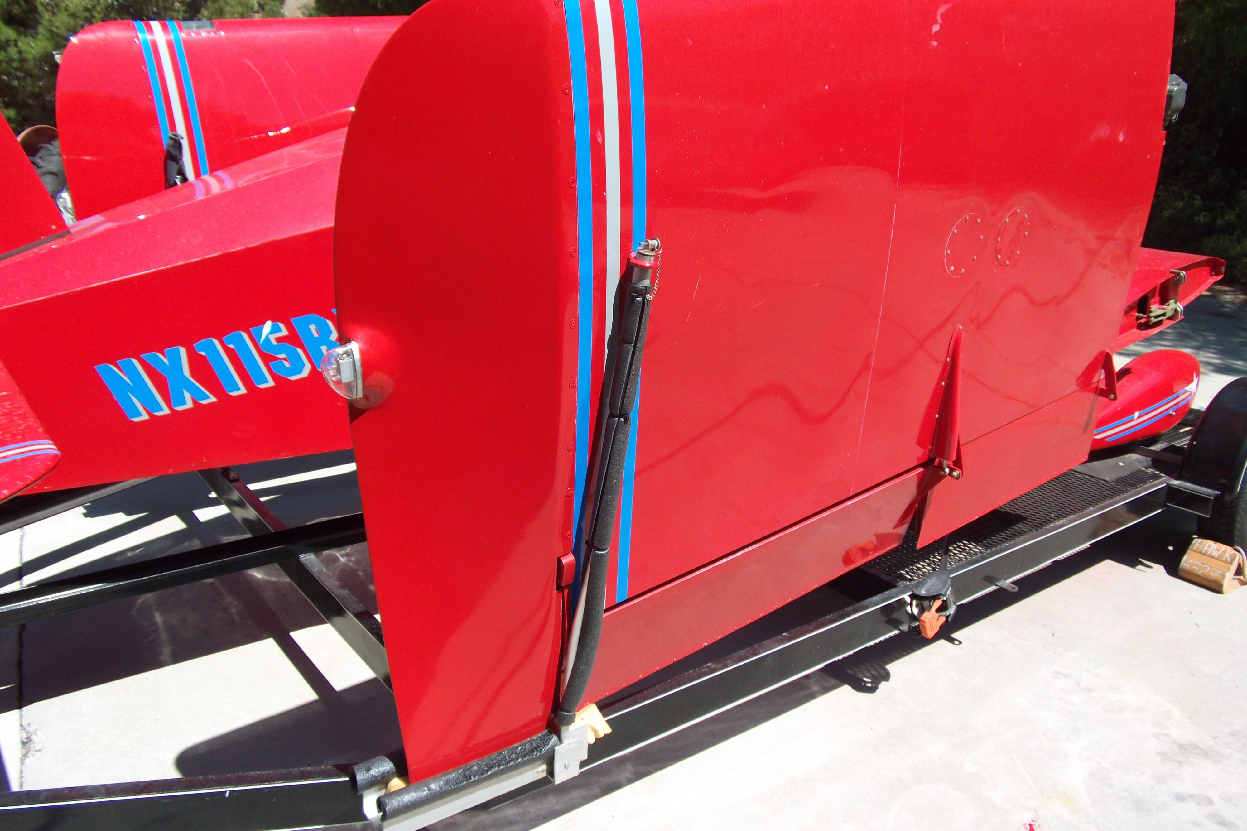

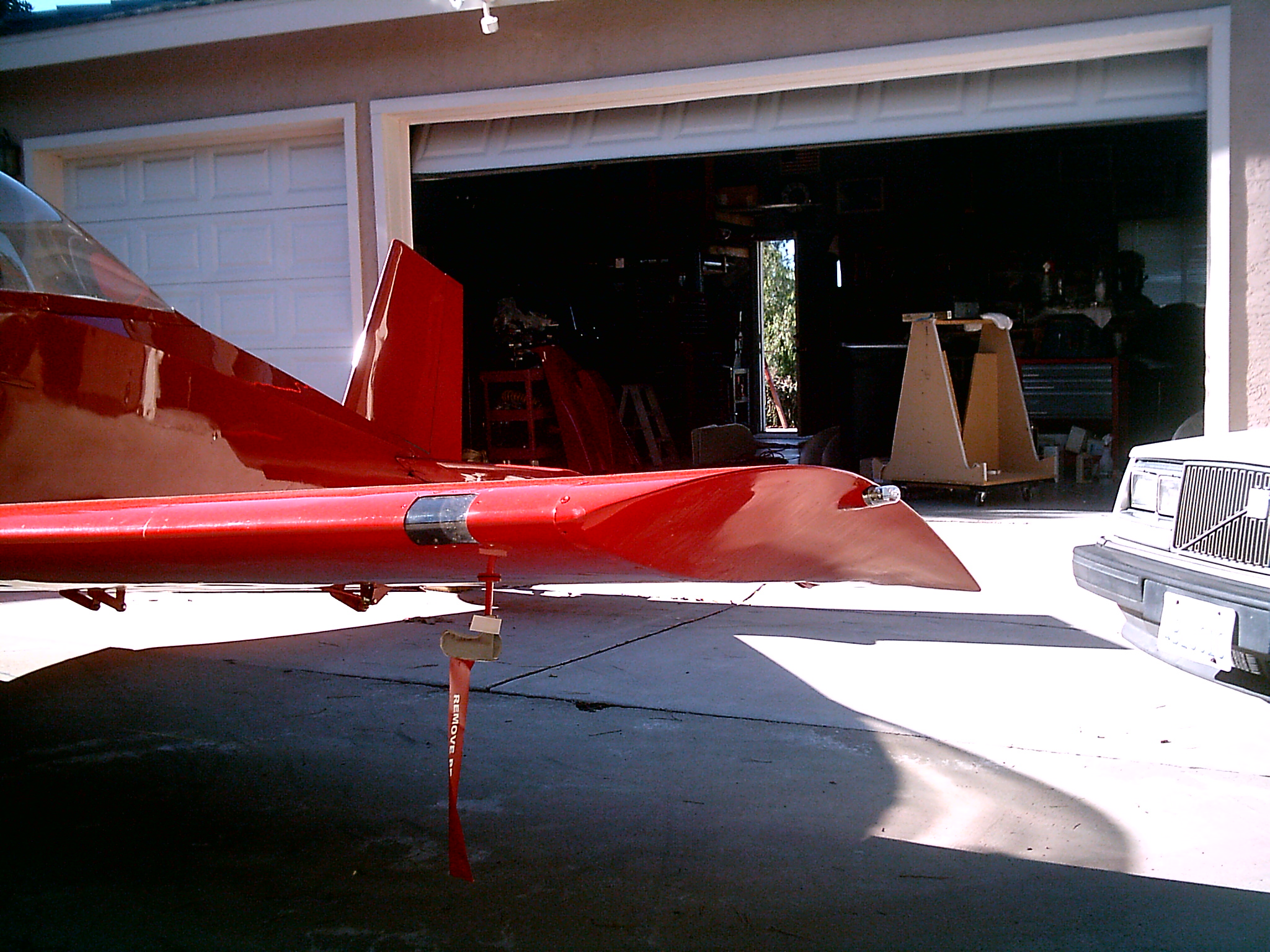

Lites on my S-18 . Took a piece of fiber glassing foam and shaped to fit the lites and the tip . Not as hard as I thought . Still hate working with the fiber glass goo ! :P

Those look nice Rich! These tips are already painted but I guess they can always be repainted. I'm guessing you fabricated, then painted the wingtips. Are those LED nav lights/strobe light combos?
 Post subject: Re: HOERNER WING TIPS
PostPosted: Mon Nov 05, 2018 11:35 pm
Yes fab then painted as this was a new build AC . :o I used the Kuntzleman LED combo strobe/position lites . Installed back in 2011 and have worked flawlessly . ::) Now of course they have more "advanced" units and have a smaller footprint . http://www.kestrobes.com
