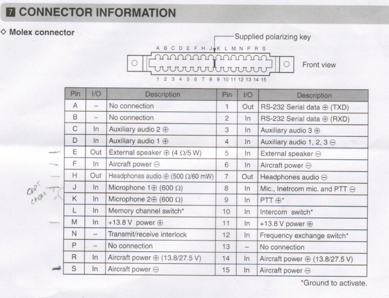

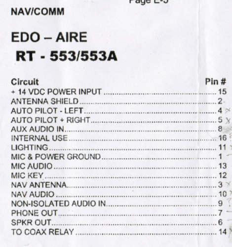

I removed an EDO-AIRE RT533 Nav/Comm from the T-18 and was looking forward to a relatively painless swap to a new Icom A210, unfortunately it doesn't appear to be simply a matter of moving some wires to the molex connector since the language used to describe some wires is different enough to make me unsure of what to do... I'll try to explain....
The plug for the EDO-AIRE id numbered 1 through 16
I found a pin out table online for the 533 and have the manual for the A210...
posting pics... questions to follow...

I am struggling matching the existing wires with the pin-out diagram of the A210...I see in the instructions that I am to use two power (battery) ground wires at 6 and F as well as S and 15....
Then jump M to 11 and P to 13and 2 13.8 V power (+) wires at R and 14.
Am I right so far?
another Q... the instructions indicate there is a SUPPLIED POLARIZING key between J-K and 8-9... I dont see that; what do they mean?

Here is a quick & dirty view. The ICOM has a built in intercom, which you will not use if you keep the ISCOM. The ISOCOM uses airframe ground for all the audio grounds so ICOM pin 8 goes to ground. So other than power & ground connections, you will only need to connect
Headphone signal (ISCOM 'B' to ICOM 'H')
Mic signal (ISOCOM 'F' to ICOM 'J') (wants to be shielded wire)
Push to Talk (ISOCOM '7' to ICOM '9')
and speaker + (from ICOM 'E')
The polarizing key is a little widget that prevents the connector from being installed upside down.
