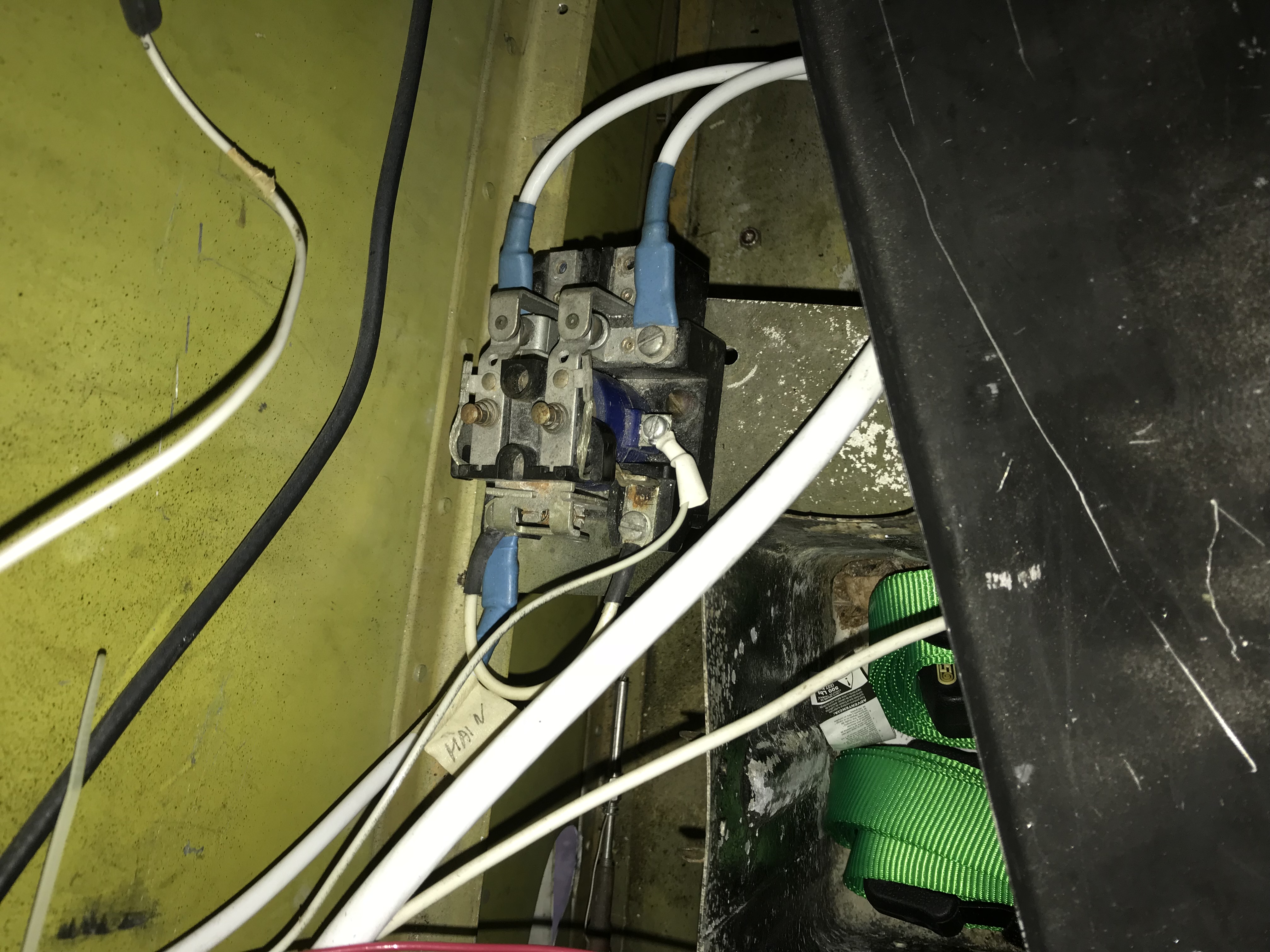

I finally got around to moving the battery to the firewall. After removing the starter solenoid I pulled a cover attached to the airframe expecting to see a master solenoid but found this instead. If it is a master solenoid, it is different than any I have ever encountered. It looks like an old school voltage regulator without the factory cover to me but that doesn’t make sense because that would make 2 on the airplane and the starter solenoid would have been pulling double duty. The two 8 gauge wires at the top were connected to the hot side of the starter solenoid. Any thoughts?

Hummm ? I saw that relay in the Smithsonian when we toured the Thomas Edison exhibit ! ???
PostPosted: Tue Sep 25, 2018 5:40 pm
That's a DPST relay, we used these for years in the Xray machines as power contactors. Probably was used in the builders home air conditioner. I guess necessity is the mother of invention.
It's not a sealed contactor and if you had a fuel leak , I think the first thing you would remember is a loud noise.

I had one similar to yours, since been replaced with one from B & C.
PostPosted: Tue Sep 25, 2018 6:21 pm
Thanks guys. A local heating and air guy identified it for me a little bit ago. I will pick up a heavy duty battery solenoid from the National Airplane Parts Association on my way through town in the morning.
