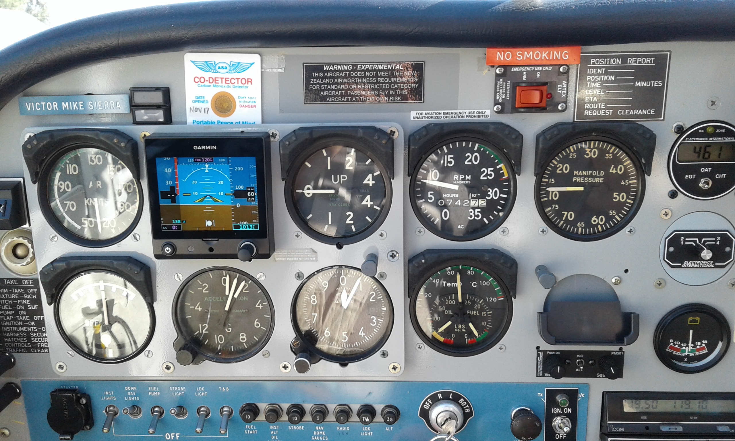

I would be very interested in seeing a picture of anyone’s panel after a G5 installation, if you wouldn’t mind sharing? Thank you

Pic of panel and G5.

 Post subject: Re: GARMIN G5
PostPosted: Sat Feb 24, 2018 8:32 pm
Tony,
it looks like you have a full panel, is you G5 coupled to your radio ?

TonyNZ
PostPosted: Sun Feb 25, 2018 4:45 am
Images: 8
Location: New Zealand
No, G5 is stand alone. Have not got the magnetic compass module either. No IFR stuff for me.
