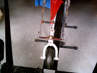

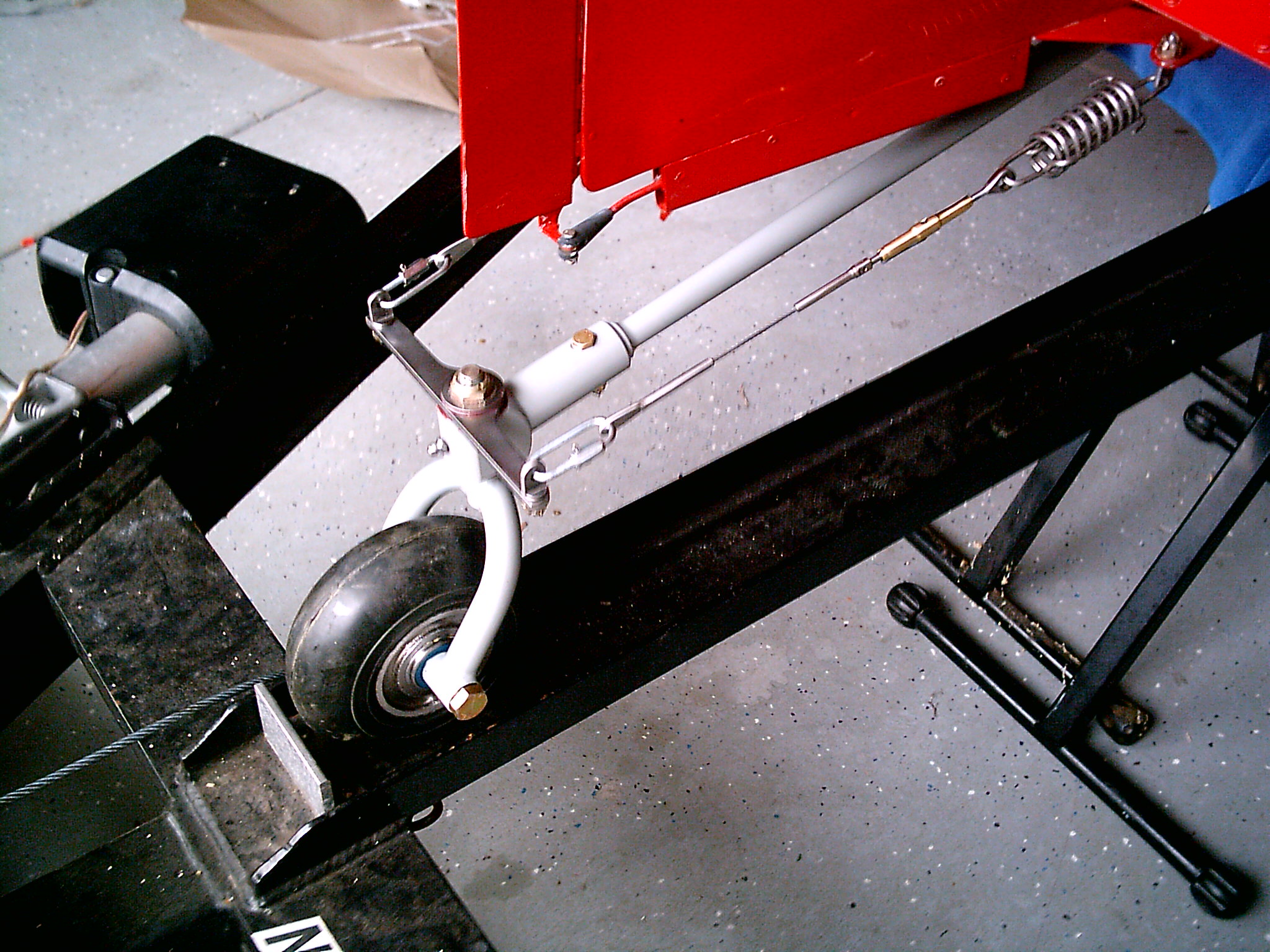

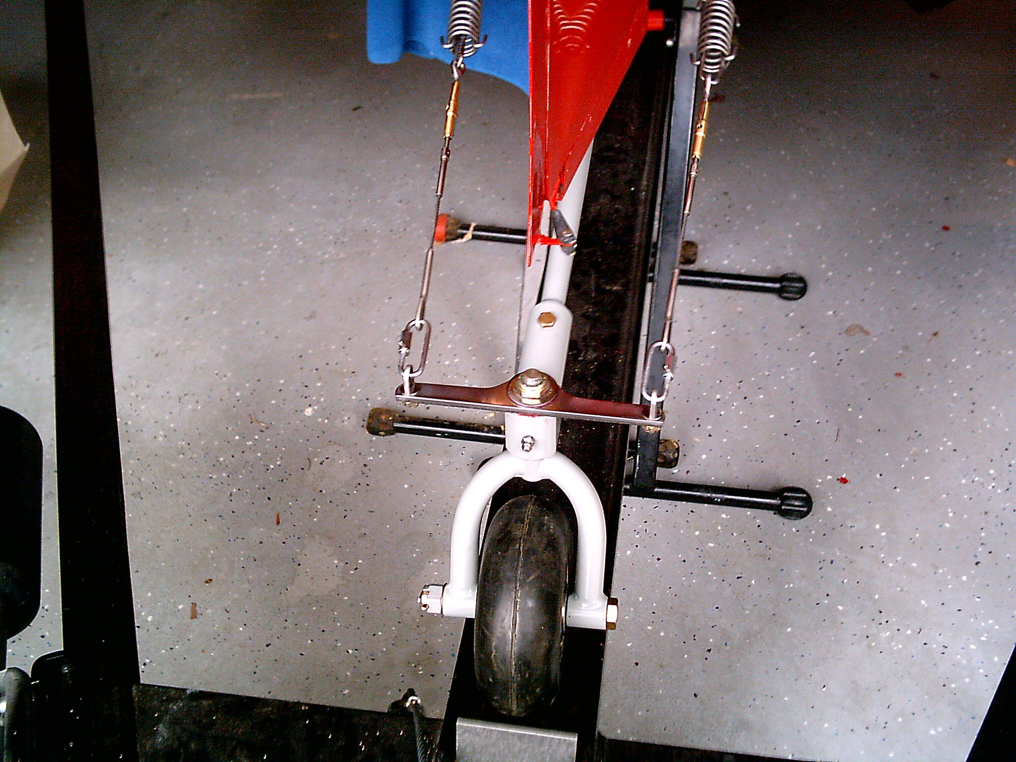

Got tired of painting mine . Had the spring and fork powder coated . About $75.00 here in SAN .

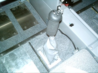

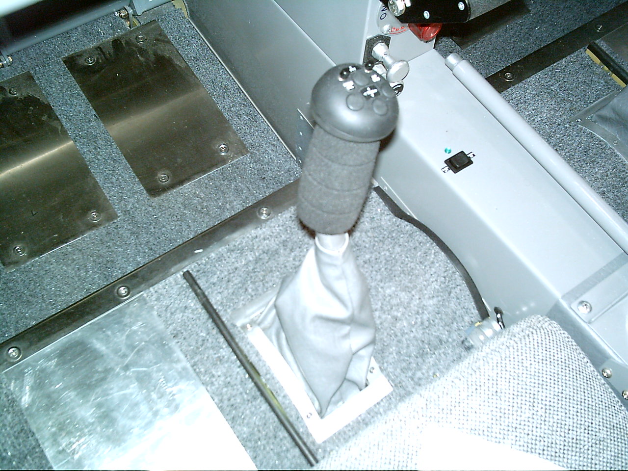

I find the electric trim very useful during cruise especially with the auto pilot on . Anything I can do to reduce fatigue in the cockpit , I'm up for it . During the landing phase I just reset it to the takeoff position . I have a small green LED lite next to the trim switch to indicate the T/O position as can be seen in the attached pic . ???
