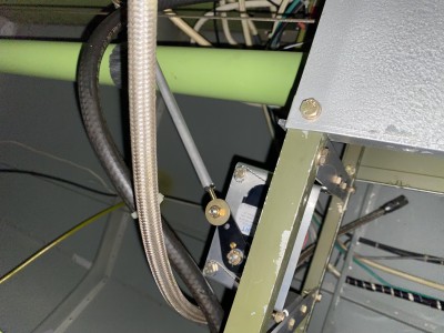

MartyG
PostPosted: Thu Jan 20, 2022 2:47 pm
Joined: Mon Jun 07, 2021 8:29 pm
Posts: 48
Location: Y51 - Viroqua, WI
I don't have great pics but I snapped a couple quick ones of my mount at least. Mine has a rod connecting the servo to the elevator tube also, but the travel isn't enough. **the rod is not connected in the photo. It is parallel with the elevator tube when connected**
I called GRT and they are going to send me a longer arm that bolts up to the servo, we will see if that's enough. Otherwise, I think I'm just going to have to make an extender out of some aluminum to get it to the right length.
No matter what I do the pics show up upside down, sorry about that.
Marty G

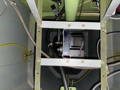

PostPosted: Thu Jan 20, 2022 9:35 pm
Posts: 231
I took this pic for something else but it shows how I mounted my MGL avionics servo. That is a smoke oil pump beside it.

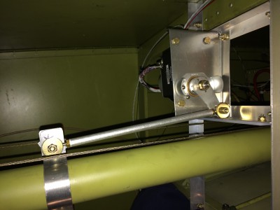

PostPosted: Sat Jan 22, 2022 3:31 pm
Posts: 506
This is my install of a Garmin GS28 servo, I had to get the longer servo arm, needed 1.75" throw and the standard arm max is 1.5". The servo is mounted on the aft side of the -571 bulkhead (the aft bagage compartment bulkhead).
There is something happening when photos are included, this is upside down (rotated 180deg), it displays just fine on my computer.

MartyG
PostPosted: Mon Feb 28, 2022 11:07 am
Posts: 48
Just wanted to update this with my final solution and a pic. The longer servo arm that GRT supplied me worked perfectly. I now have full elevator travel with only about 45 degrees of travel either way off center. Looks like it's all going to work out!
