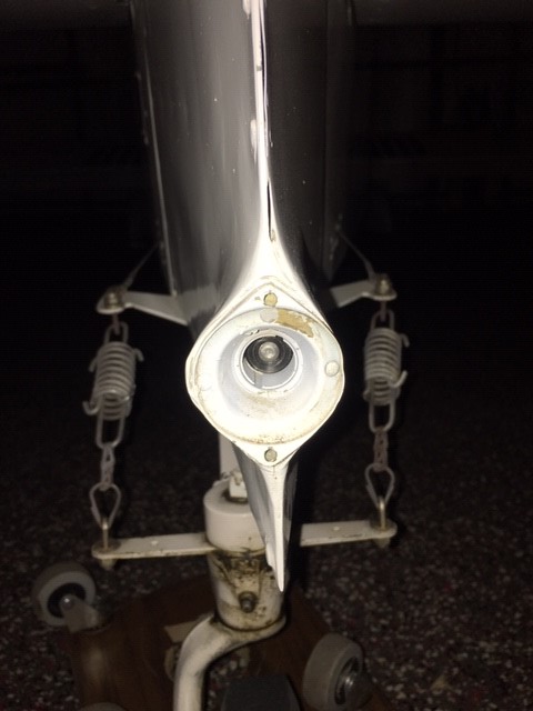

Anyone install one on their Thorp? I can't see how this thing will fit.

I've read the instructions but it looks like I need to drill out some rivets to get the actual light socket out so that the beacon fits in the hole and I can wire it up. Here is a pic.

 Post subject: Re: Tailbeacon
PostPosted: Mon Oct 28, 2019 6:31 pm
I see what you mean. It sure looks like you're going to need to drill out a couple of rivets in order to mount the tailbeacon base.
PostPosted: Tue Oct 29, 2019 10:13 am
Yes usually that socket is not riveted in ... typically the upper and lower rivets on your plane are screws and the base is tapped. I'd drill those out and tap them for the skybeacon.

Thanks Lee, I'll give that a go.

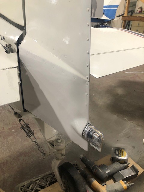

Thought I'd post an update. Got it all going and past the faa test - guess this baby will still be flying next month :D
