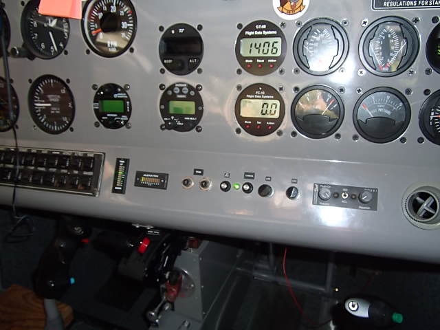

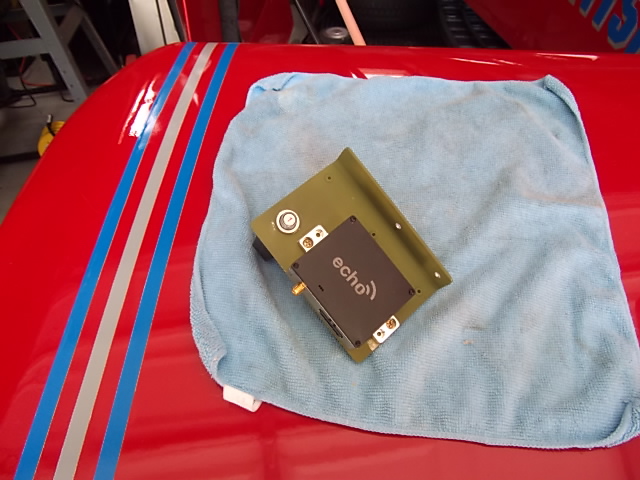

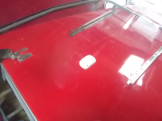

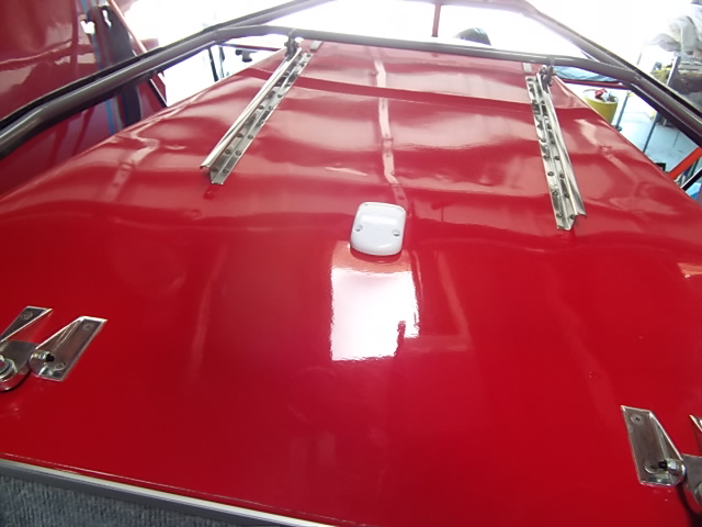

95% complete on the install of the uAvionix ADS-B Echo/skyFYX unit . Installed the Echo portion of the unit behind the baggage compart along with the required 1 amp CB . I used the 2 foward attach screws from the skyFYX to secure the mounting bracket for the CB and Echo . Then it was just a matter of providing a power source which I did thru a push button switch on the inst. panel along with a green led "ON" lite . Awaiting on a premade coax cable with the appropriate end fittings , then the Echo will be attached to the UAT antenna on the bottom of the AC . The skyFYX GPS antenna/receiver was installed on the canopy deck between the rails . The skyFYX needs a clear view of the sky . Once the coax and antenna are hooked up , then I can program the unit via WiFi/Smart Phone (this is where my wife surpasses my giant brain capacity with using a "Smart Phone !) Hopefully I can give the unit a good workout on the way to KVIS and report the results . That is all . :P

Bill : I mounted my Echo unit behind my baggage compartment under the canopy deck using the two foward screws of the SKYFYX GPS antenna receiver that I mounted on the canopy deck . The UAT antenna (looks just like a "stick type" transponder antenna) needs to be mounted on the belly as long as it is at least 1 meter from your VHF and transponder antenna . Looks like your lower VHF antenna location is good . I would get out the old trusty tape measure and look at placing the UAT antenna on the belly in the area of the flap cables , based upon your transponder antenna location ?
