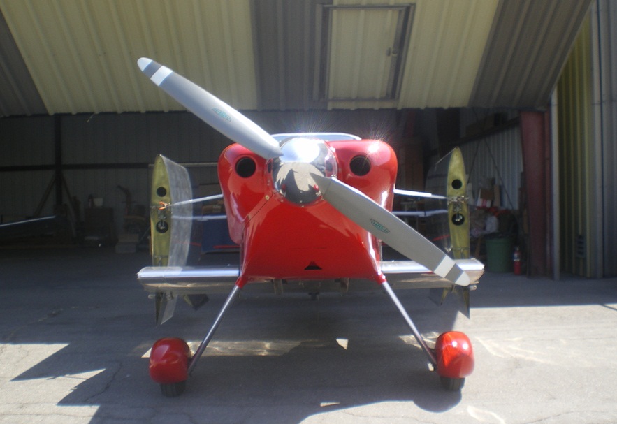

Has anyone come up with a good way to support the folded S18 wing? I'm thinking some sort of saddle across the fuselage, and maybe drill and tap the main spar for an eye bolt. Any suggestions/pictures appreciated.
Thanks,
Pancho
Rv3maker
PostPosted: Tue Jun 17, 2025 5:00 pm
Joined: Sun Oct 15, 2023 9:06 am
Posts: 51
Location: Halstead, KS (Wichita area)
Look at Terry Adams pictures in the albums. Terry's polished T-18C had several bars that seem to attach to the main pin holes and then to the canopy fuse side and then had a rear cross bar. Maybe you could contract Terry and ask if he has more photos? I considered buying his aircraft but decided I needed a bit wider cockpit.
Here is one from when he listed his aircraft.
Rob
