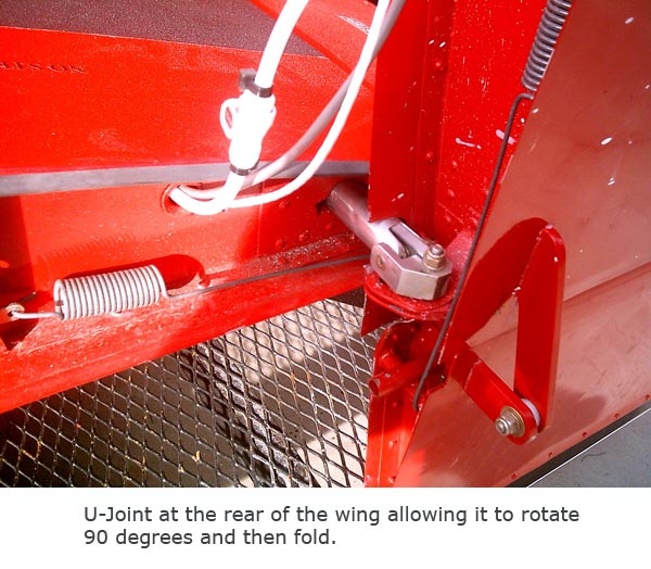

I have always thought that a folding winged S-18 would be great. But it just occurred to me that a device similar to a rod end bearing is used at the rear spar to rotate the wing on and to act as the rear spar. It would surely provide enough strength to prevent twisting of the wing, but would seem to offer zero strength in resisting wing bending with G loads. And all of the wing bending resistance would be transferred to the main spar. The non-folding winged T&S-18's have a continuous rear spar that would no doubt share some of the wing bending loads during G load. I don't know if I'd want to give that up to get a folding wing. I also prefer the appearance of the mid wing dihedral break, instead of the break occurring near the fuselage side. The mid wing break reminds me of the F-4 Phantom's wing. I think that's one of the neatest aspects of the Thorps appearance. But for highway trailering that would make the mid wing section too wide, so there was really no other way to solve that one. I just wonder with the current S-18 kit, if one chooses to build a non-folding version of the wing, if the dihedral break can be put where the original wing had it? Or is the wing kit only made to use the inner version of the break made for the folding winged S-18? If a non-folding wing S-18 is built, there's really no reason for the dihedral break to be made at the inward location. Unless one prefers the appearance of that. And I know some do. To each his own in that regard. I do think the newer Sunderland airfoil is safer to use whichever way the wing is built.

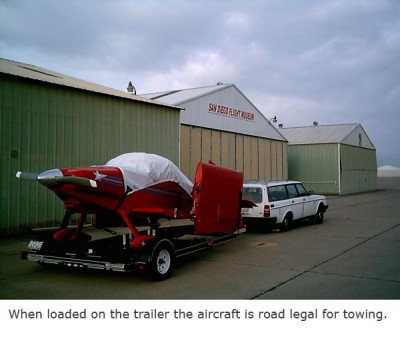

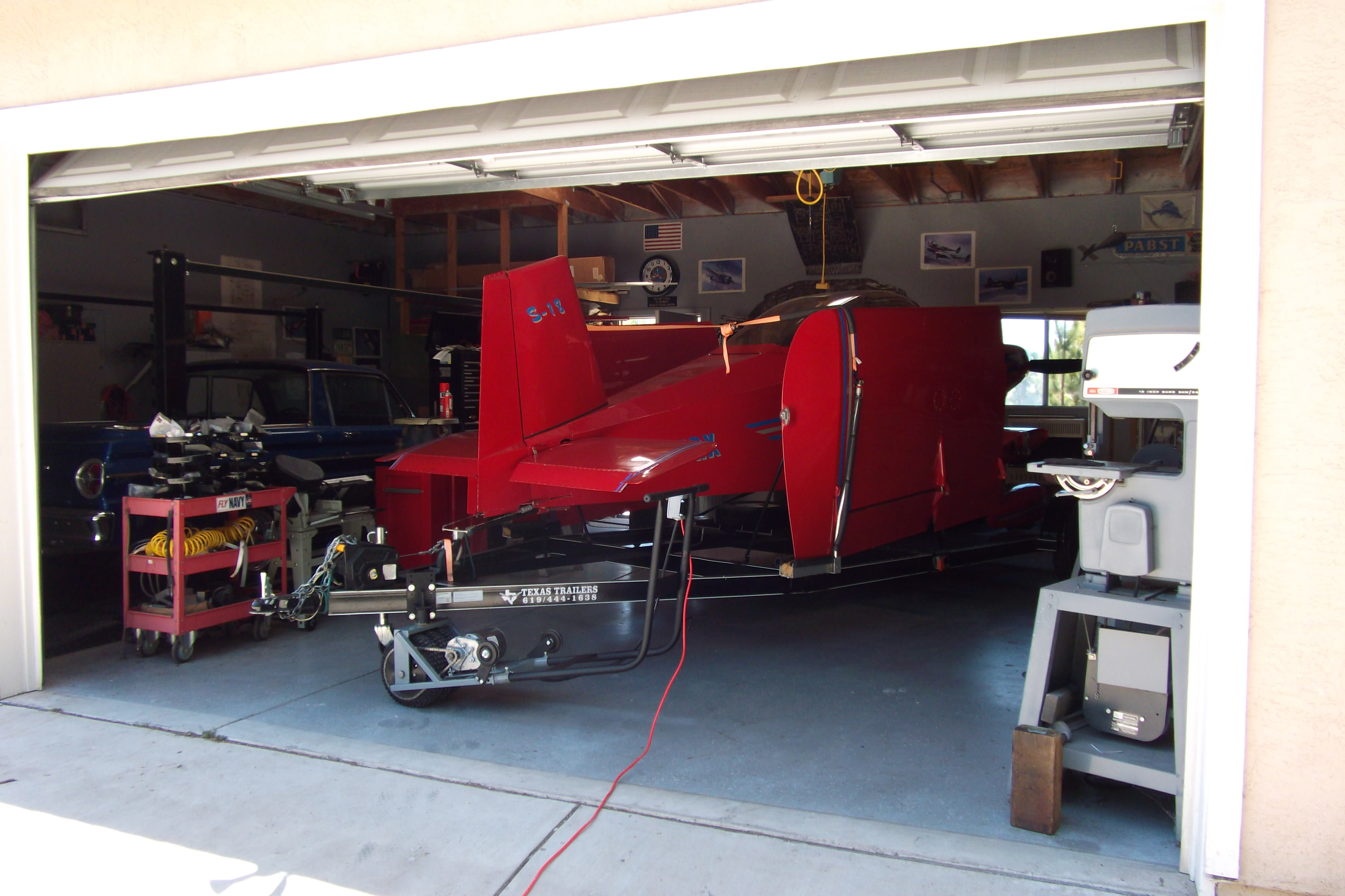

If you care not to fold the wing , just bolt it in place and leave it alone . I have had the folding wing version since 2011 (first flight) and have been very happy with it . I have had the AC stored at home here in San Diego for the last 8 years . Hangars are at a premium and years on a waiting list . After 8 years I finally broke down and rented a hangar at KSEE . Figure 8 years x $500.00 month (keeping AC at home on trailer) , that's $48,000 . A good investment in my book !
As far as the trailer my design came from Gus Gordon . With wings folded and on the trailer the whole rig is California street legal ! I am not an engineer but , the "universal joint" on the rear of the wing is more for transporting the wing than flying . I know the "pip pin" is not structural and can actually be missing . I'll let the engineers chime in regarding universal joint . If you do not want to fold the wing but , want the Lou Sunderlund wing use bolts to secure it in place . You may need NAS bolts or hand fit them to get a snug/no play in the wing at the wing attach point at the wing break .

The aft spar has a pin in it to carry the loads. The universal is not for carrying that load. You can use an AN bolt there as well.
In your last post, you describe the T18W. Bottom line is that you can build it however you want.

The rear spar fittings on this airplane, folding or standard wing, are not designed for carrying bending loads at the joints between the fuselage, inner and outer panels. The main spars and associated fittings carry those loads.
