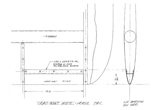

4. Stabilator Counter Balance Weights- Refer to T-18 Drawing A-510, C-595, -623, Newsletters# 27, 39 and 40. This SDR refers to the the lead weights used to counter balance the stabilator. The original tail had all of the lead weight installed on the center mounted horizontal tail mast (refer to item 2 above). This was revised in 1968. Basically the weight was split into thirds, with about 2.2 pounds remaining mounted to the horizontal tail mast. The remaining weight was then cut in half and added to each tip of the stabilator. In the early versions the tip weight was installed externally in the form of bullets, with each bullet weighing 3 pounds. These are really easy to see and many T-18 are flying with these external tip weights. At some point the tip weights were molded to fit the leading edge curve and were installed inside the stabilator tips, and weigh about 3 pounds each. These are a little harder to verify, but there is usually some external evidence of their presence in the form of rivets or screws that are used to secure the lead weights into the leading edges. If nothing is evident then you may need to remove the stabilator tip and end rib to verify that the internal weights are present. Click here for a drawing of a typical internal weight installation.
