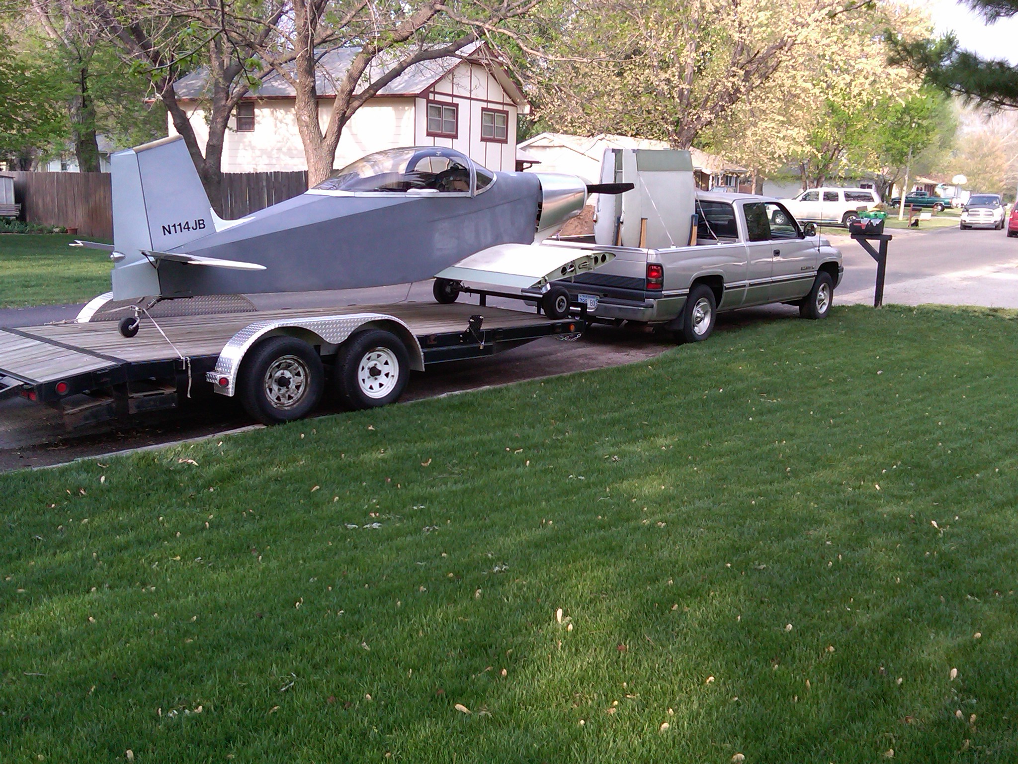

I just passed 50 hours of flight last Saturday. I took the plane apart and brought it home for paint, interior and electric aileron trim. I am tired of people making fun of the four colors of primer. I went to a Cessna Aircraft surplus sale and purchased four hides of leather and four different fabrics, and a roll of carpet for $25. There is enough there to do many planes.

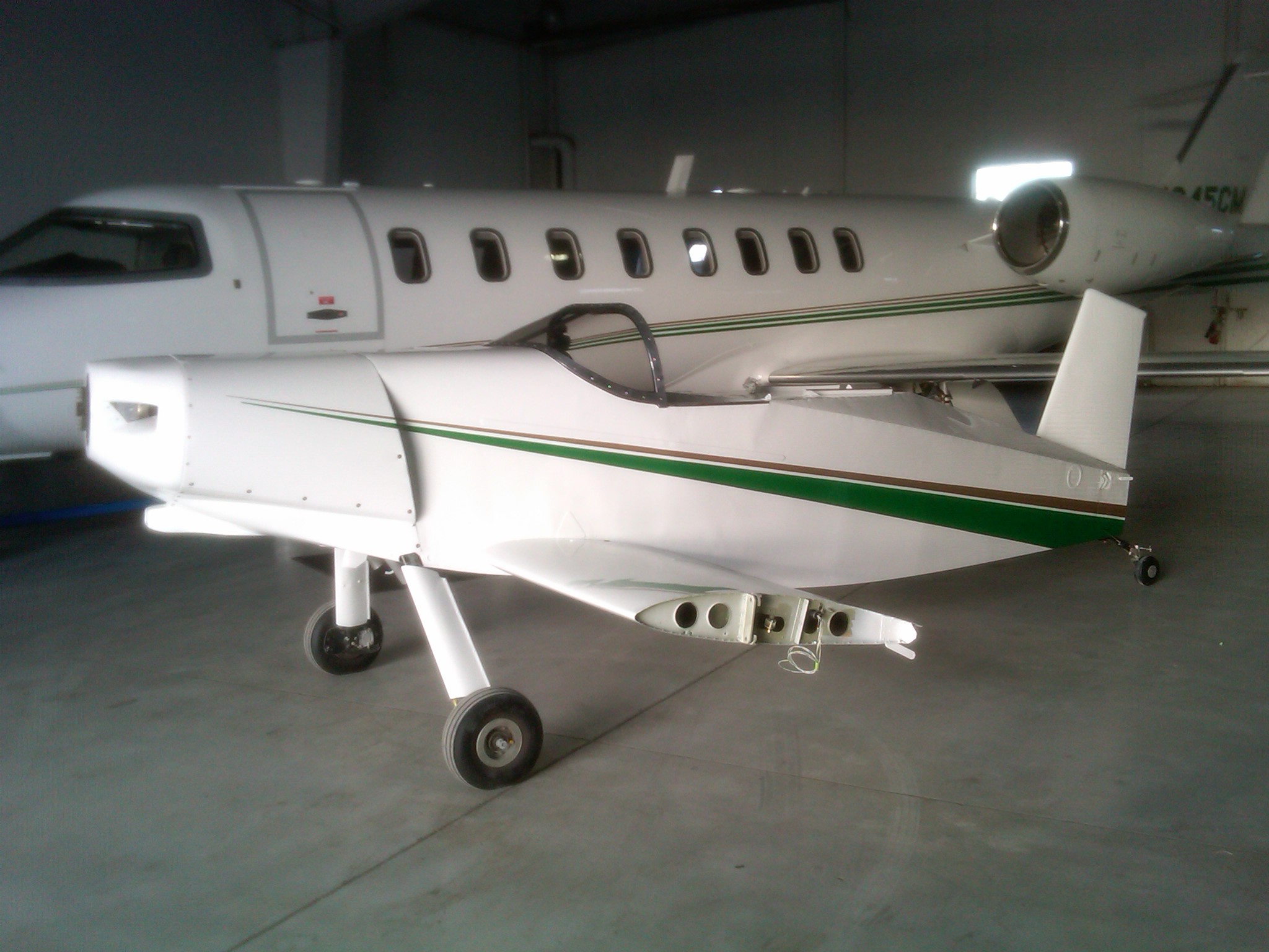

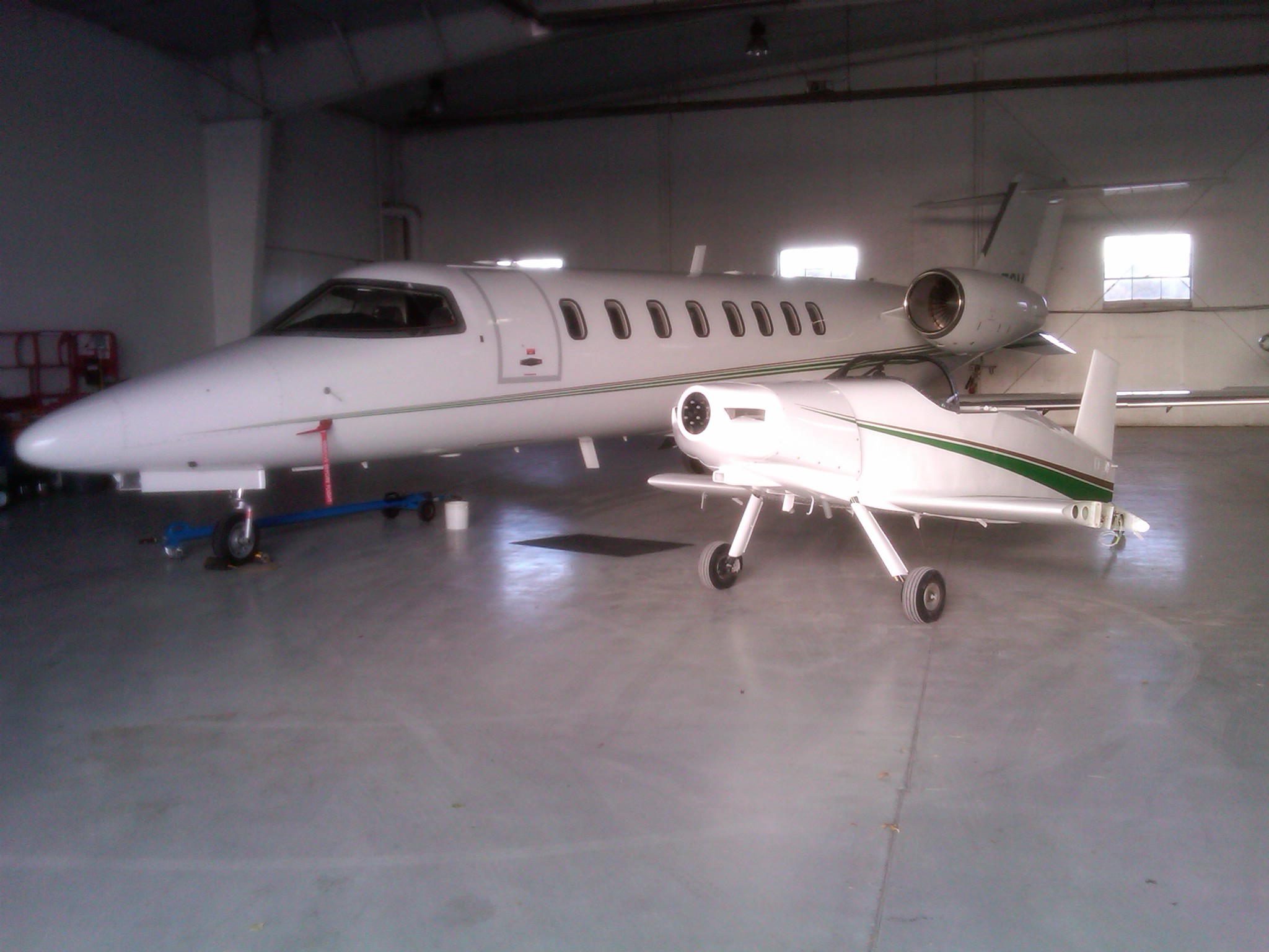

Jeff Blanton Posted - 10/31/2011 : 07:50:04
Thanks Lee! It was a lot more work after I removed the laquer primer. I removed so much bondo with a heat gun and plastic scraper it will probably be lighter now! I about filled up a black yard bag! Sherman Williams epoxy primer and Jet Glo paint, with no bondo this time. I am very happy the way it turned out.

My paint is complete. Here is a picture of my plane sitting next to its big brother. Should be flying soon!

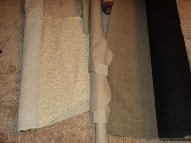

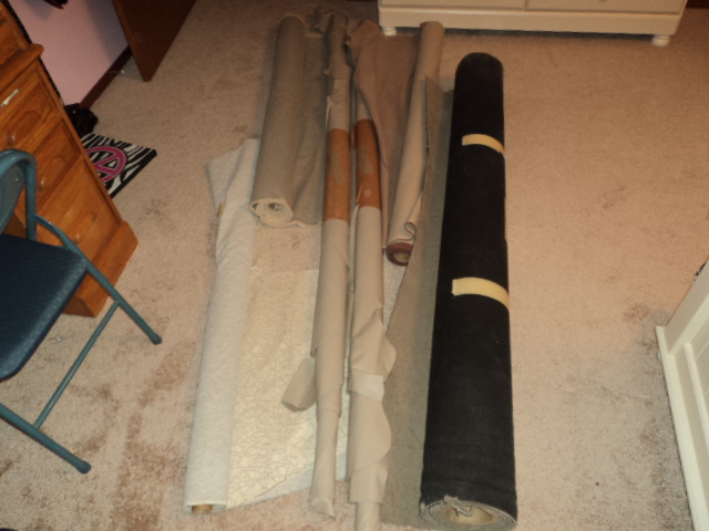

This is the stuff from Cessna. The two other hides will be on my dad's Breezy he is building. I am using the fabric with the wavey lines, the carpet and tan leather. I think I will hang on to the extra for now. There is one thing I need advise on. I have been flying off grass and I hear an oil canning sound around my left leg area, and I can sometimes feel it in the former by my leg on taxi and roll out. The strip is moderately smooth. I don't notice anything on paved runways. Is this normal, or do I need to do something before paint? Larry I am in Wichita KS.

larry Posted - 04/20/2011 : 15:17:03
i cant get my grass looking like that must be the new england weather
Bill Williams Posted - 04/20/2011 : 14:13:45
Lookin mighty Thorpie...Nice looking bird. As for the paint, I flew mine for over a year in primer. It had stripes along the rivet lines and people called it "spot"
